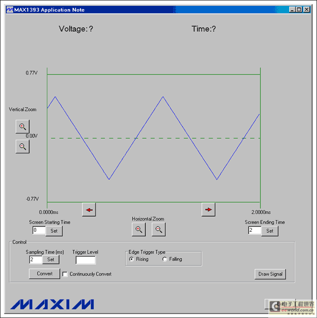

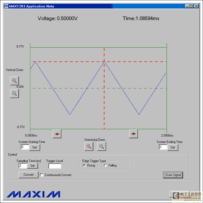

将MAX1396EVKIT通过USB电缆连接到PC机后,固件将等待接收Windows程序命令,如图3所示。按下Convert键接收评估板采集的输入信号数据,然后显示数据波形(图4)。当鼠标光标放置在波形区域时,将在屏幕顶端显示相应的时间(Time)和电压(Voltage),如图5所示。表2给出了其它软件功能。

图4. 显示波形
图4. 显示波形
图5. 在屏幕顶端显示时间和电压
图5. 在屏幕顶端显示时间和电压
表2. 软件功能
Button Description
Vertically scales the waveform.
Horizontally scales the waveform.
Shifts the waveform horizontally.
Enter a value (in milliseconds) into the edit box and press the Set button to set the starting time at the left of the screen.
Enter a value (in milliseconds) into the edit box and press the Set button to set the ending time at the right of the screen.
Enter a value (in milliseconds) into the edit box and press the Set button to set the sampling time.
Enter a proper trigger-level value into this edit box.
Click on one of the two radio buttons to choose either rising-edge triggering or falling-edge triggering.
Press this button to receive input-signal data from the EV kit board and display the waveform on the screen.
Select this checkbox to receive continuous data from the EV kit and continuous updates to the waveform on the screen.
Press this button to redraw the waveform on the screen.
Press this button to exit the program.
