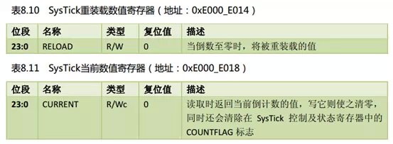

  __IO uint32_t CTRL; /*!< Offset: 0x00  SysTick Control and Status Register */
  __IO uint32_t LOAD; /*!< Offset: 0x04  SysTick Reload Value Register       */
  __IO uint32_t VAL; /*!< Offset: 0x08  SysTick Current Value Register      */
  __I  uint32_t CALIB; /*!< Offset: 0x0C  SysTick Calibration Register        */
} SysTick_Type;

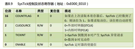

/* SysTick Control / Status Register Definitions */控制/状态寄存器
#define  SysTick_CTRL_COUNTFLAG_Pos  16      /*!< SysTick CTRL: COUNTFLAG Position */
#define SysTick_CTRL_COUNTFLAG_Msk         (1ul << SysTick_CTRL_COUNTFLAG_Pos)
/*!< SysTick CTRL: COUNTFLAG Mask */ 溢出标志位
#define SysTick_CTRL_CLKSOURCE_Pos   2       /*!< SysTick CTRL: CLKSOURCE Position */
#define SysTick_CTRL_CLKSOURCE_Msk         (1ul << SysTick_CTRL_CLKSOURCE_Pos)
/*!< SysTick CTRL: CLKSOURCE Mask */时钟源选择位,0=外部时钟;1=内核时钟
#define SysTick_CTRL_TICKINT_Pos      1        /*!< SysTick CTRL: TICKINT Position */
#define SysTick_CTRL_TICKINT_Msk           (1ul << SysTick_CTRL_TICKINT_Pos)
/*!< SysTick CTRL: TICKINT Mask */异常请求位
#define SysTick_CTRL_ENABLE_Pos             0       /*!< SysTick CTRL: ENABLE Position */
#define SysTick_CTRL_ENABLE_Msk            (1ul << SysTick_CTRL_ENABLE_Pos)
/*!< SysTick CTRL: ENABLE Mask */使能位

#define SysTick_VAL_CURRENT_Pos             0       /*!< SysTick VAL: CURRENT Position */
#define SysTick_VAL_CURRENT_Msk            (0xFFFFFFul << SysTick_VAL_CURRENT_Pos)
/*!< SysTick VAL: CURRENT Mask */

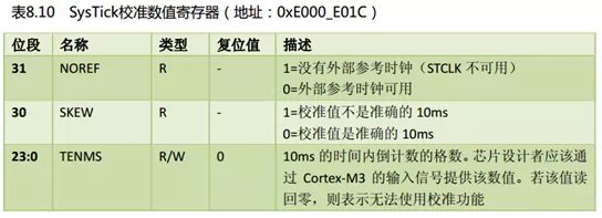

/* SysTick Calibration Register Definitions */
#define SysTick_CALIB_NOREF_Pos            31      /*!< SysTick CALIB: NOREF Position */
#define SysTick_CALIB_NOREF_Msk            (1ul << SysTick_CALIB_NOREF_Pos)
/*!< SysTick CALIB: NOREF Mask */
#define SysTick_CALIB_SKEW_Pos             30       /*!< SysTick CALIB: SKEW Position */
#define SysTick_CALIB_SKEW_Msk             (1ul << SysTick_CALIB_SKEW_Pos)
/*!< SysTick CALIB: SKEW Mask */
#define SysTick_CALIB_TENMS_Pos             0       /*!< SysTick CALIB: TENMS Position */
#define SysTick_CALIB_TENMS_Msk            (0xFFFFFFul << SysTick_VAL_CURRENT_Pos)        /*!< SysTick CALIB: TENMS Mask */

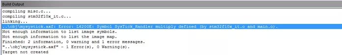

Void SysTick_Handler (void)
注意:
如果在工程中,加入了stm32f10x_it.c,而又在主函数中编写中断函数,则会报错。
因为在stm32f10x_it.c文件中,也有这个中断函数的声明,只是内容是空的。

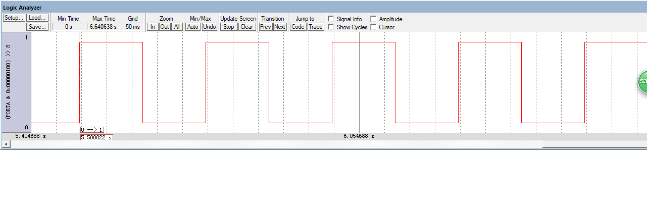

模拟后的结果
1、8分频后结果

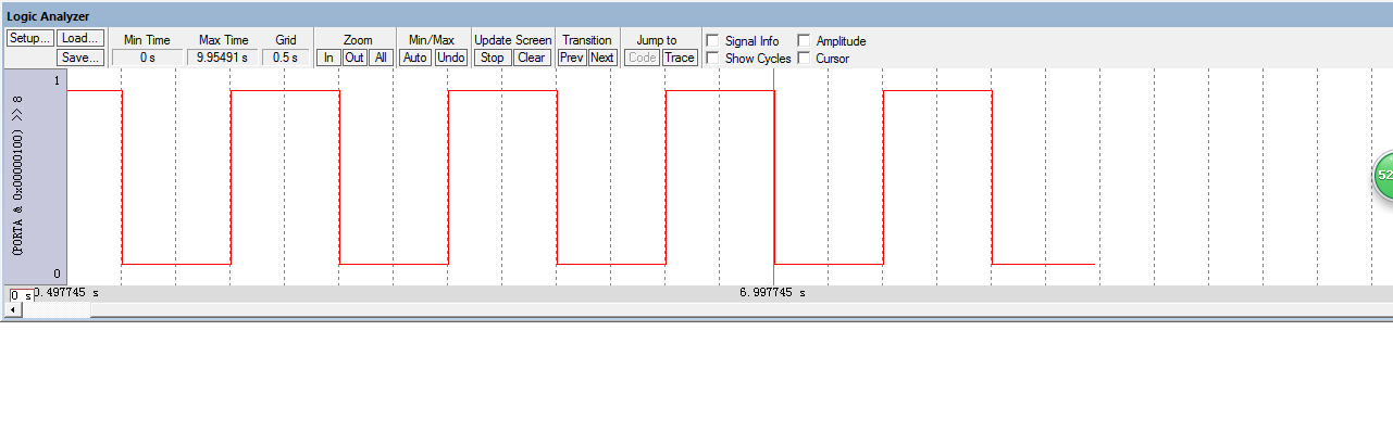

2、直接调用SysTick_Config(9000000);即不分频的结果,间隔为1/8=0.125s
