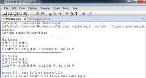

将SD卡插入电脑,并让VmWare里的Ubuntu识别出来,然后执行如下命令:
sudo ./sd_fusing.sh /dev/sdb ../7_open_icache/open_icache.bin
如下图所示:
open_icache
