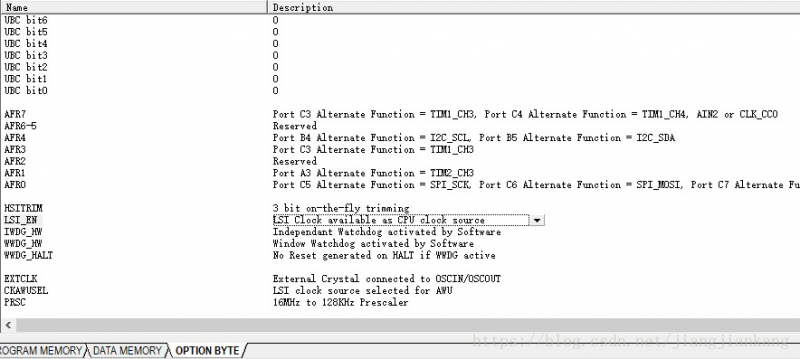

1. 关于HSE的时钟配置为主时钟
static void CLK_Config(void)
    CLK_DeInit();  // 初始化
    CLK_HSECmd(ENABLE); //使能HSE
   CLK_ClockSwitchConfig(CLK_SWITCHMODE_AUTO, CLK_SOURCE_HSE, DISABLE,
                                CLK_CURRENTCLOCKSTATE_DISABLE); //切换HSE 并关闭其他时钟 为自动模式
    /*Enable CSS interrupt */
   CLK_ITConfig(CLK_IT_CSSD, ENABLE);
    /* Enable CCS */
   CLK_ClockSecuritySystemEnable();
    /* Output Fcpu on CLK_CCO pin */
CLK_CCOConfig(CLK_OUTPUT_HSE);   //通过PC4可以查看输出
 CLK_CCOCmd(ENABLE);
 enableInterrupts();
2. 关于HSI的时钟配置为主时钟
CLK_HSIPrescalerConfig(CLK_PRESCALER_HSIDIV2); //直接配置即可
3. 关于LSI的时钟配置为主时钟
     CLK_DeInit();   //初始化
    CLK_LSICmd(ENABLE); //使能LSI
    CLK_ClockSwitchConfig(CLK_SWITCHMODE_AUTO,CLK_SOURCE_LSI,DISABLE,
   CLK_CCOConfig(CLK_OUTPUT_LSI);    //PC4输出
   CLK_CCOCmd(ENABLE);
这里还需要在STVP中设置OPTION BYTE
LSI_EN     LSI  Clock available as CPU clock source
这样就可以了
