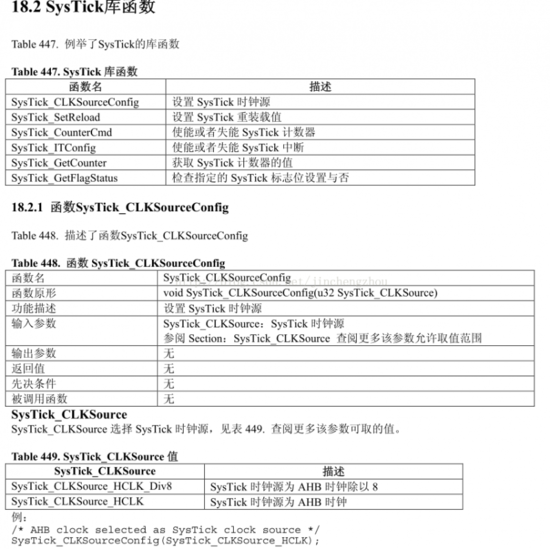

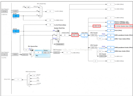

1.systick时钟来源
2.SysTick库函数
3.源码
/** @defgroup SysTick_clock_source
#define SysTick_CLKSource_HCLK_Div8    ((uint32_t)0xFFFFFFFB)
#define SysTick_CLKSource_HCLK         ((uint32_t)0x00000004)
#define IS_SYSTICK_CLK_SOURCE(SOURCE) (((SOURCE) == SysTick_CLKSource_HCLK) || \
                                       ((SOURCE) == SysTick_CLKSource_HCLK_Div8))
  *@brief  Configures the SysTick clocksource.
  *@param  SysTick_CLKSource: specifies theSysTick clock source.
 *   This parameter can be one ofthe following values:
 *     @argSysTick_CLKSource_HCLK_Div8: AHB clock divided by 8 selected as SysTick clocksource.
 *     @arg SysTick_CLKSource_HCLK:AHB clock selected as SysTick clock source.
  *@retval None
void SysTick_CLKSourceConfig(uint32_t SysTick_CLKSource)
  /* Check the parameters */
  assert_param(IS_SYSTICK_CLK_SOURCE(SysTick_CLKSource));
  if (SysTick_CLKSource == SysTick_CLKSource_HCLK)
   SysTick->CTRL |= SysTick_CLKSource_HCLK;
  else
   SysTick->CTRL &= SysTick_CLKSource_HCLK_Div8;

   /* Configure the SysTick */
SysTick_Config(SystemCoreClock / RT_TICK_PER_SECOND);//8000000/1000=>1ms
