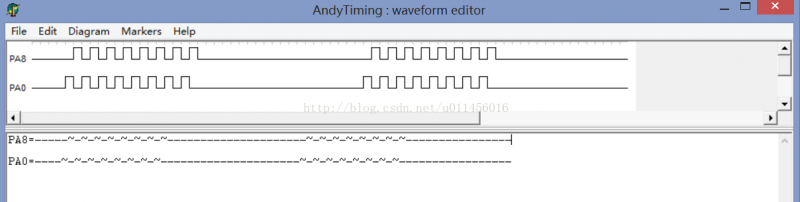

1,假如想要得到如下的波形:
每一个波的周期为25us,一组波的频率为10HZ
实现思路:
实现的时候使用TIM1的CH1和TIM2的CH1,使用TIM15的中断,每100个ms来一次中断,在中断服务函数中以中断的方式打开PWM波的输出,在输出一个PWM波之后会进入PWM的中断服务函数,在中断服务函数中计数PWM波的个数,当达到8个的时候关闭PWM波的中断输出。

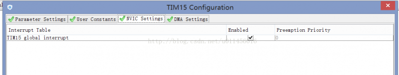

中断优先级的安排:
TIM15   1    0
TIM1     2    0
TIM2     3    0

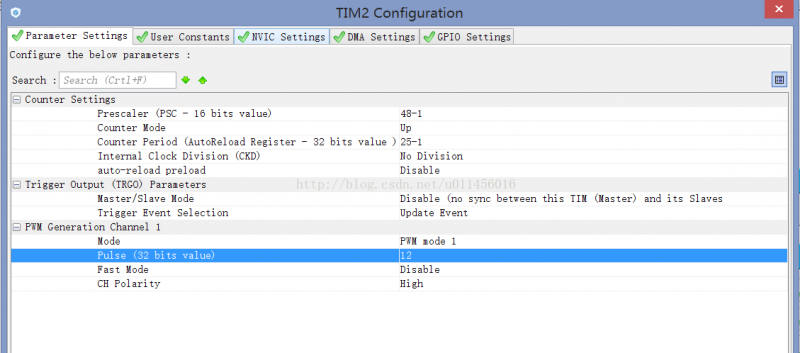

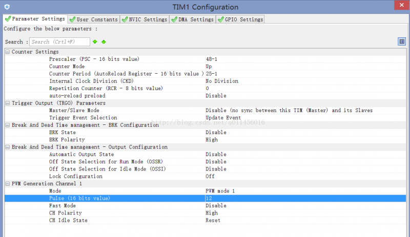

2,在CUBE中的配置

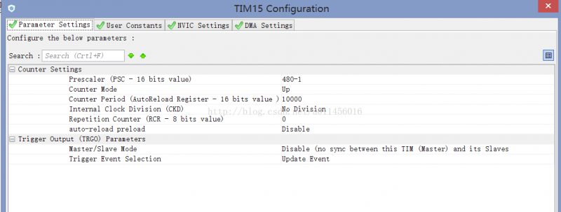

TIM15的配置:
TIM1的配置:
TIM2的配置:

  htim1.Instance = TIM1;
  htim1.Init.Prescaler = 48-1;
  htim1.Init.CounterMode = TIM_COUNTERMODE_UP;
  htim1.Init.Period = 25-1;
  htim1.Init.ClockDivision = TIM_CLOCKDIVISION_DIV1;
  htim1.Init.RepetitionCounter = 0;
  htim1.Init.AutoReloadPreload = TIM_AUTORELOAD_PRELOAD_DISABLE;
  if (HAL_TIM_PWM_Init(&htim1) != HAL_OK)
    Error_Handler();
  sMasterConfig.MasterOutputTrigger = TIM_TRGO_UPDATE;
  sMasterConfig.MasterSlaveMode = TIM_MASTERSLAVEMODE_DISABLE;
  if (HAL_TIMEx_MasterConfigSynchronization(&htim1, &sMasterConfig) != HAL_OK)
    Error_Handler();
  sConfigOC.OCMode = TIM_OCMODE_PWM1;
  sConfigOC.Pulse = 12;
  sConfigOC.OCPolarity = TIM_OCPOLARITY_HIGH;
  sConfigOC.OCNPolarity = TIM_OCNPOLARITY_HIGH;
  sConfigOC.OCFastMode = TIM_OCFAST_DISABLE;
  sConfigOC.OCIdleState = TIM_OCIDLESTATE_RESET;
  sConfigOC.OCNIdleState = TIM_OCNIDLESTATE_RESET;
  if (HAL_TIM_PWM_ConfigChannel(&htim1, &sConfigOC, TIM_CHANNEL_1) != HAL_OK)
    Error_Handler();
  sBreakDeadTimeConfig.OffStateRunMode = TIM_OSSR_DISABLE;
  sBreakDeadTimeConfig.OffStateIDLEMode = TIM_OSSI_DISABLE;
  sBreakDeadTimeConfig.LockLevel = TIM_LOCKLEVEL_OFF;
  sBreakDeadTimeConfig.DeadTime = 0;
  sBreakDeadTimeConfig.BreakState = TIM_BREAK_DISABLE;
  sBreakDeadTimeConfig.BreakPolarity = TIM_BREAKPOLARITY_HIGH;
  sBreakDeadTimeConfig.AutomaticOutput = TIM_AUTOMATICOUTPUT_DISABLE;
  if (HAL_TIMEx_ConfigBreakDeadTime(&htim1, &sBreakDeadTimeConfig) != HAL_OK)
    Error_Handler();
  HAL_TIM_MspPostInit(&htim1);
HAL_NVIC_SetPriority(TIM1_CC_IRQn, 2, 0);
  HAL_NVIC_EnableIRQ(TIM1_CC_IRQn);

  htim2.Instance = TIM2;
  htim2.Init.Prescaler = 48-1;
  htim2.Init.CounterMode = TIM_COUNTERMODE_UP;
  htim2.Init.Period = 25-1;
  htim2.Init.ClockDivision = TIM_CLOCKDIVISION_DIV1;
  htim2.Init.AutoReloadPreload = TIM_AUTORELOAD_PRELOAD_DISABLE;
  if (HAL_TIM_PWM_Init(&htim2) != HAL_OK)
    Error_Handler();
  if (HAL_TIMEx_MasterConfigSynchronization(&htim2, &sMasterConfig) != HAL_OK)
    Error_Handler();
  if (HAL_TIM_PWM_ConfigChannel(&htim2, &sConfigOC, TIM_CHANNEL_1) != HAL_OK)
    Error_Handler();
  HAL_TIM_MspPostInit(&htim2);
HAL_NVIC_SetPriority(TIM2_IRQn , 3, 0);
  HAL_NVIC_EnableIRQ(TIM2_IRQn );

  htim15.Instance = TIM15;
  htim15.Init.Prescaler = 480-1;
  htim15.Init.CounterMode = TIM_COUNTERMODE_UP;
  htim15.Init.Period = 10000;//100ms
  htim15.Init.ClockDivision = TIM_CLOCKDIVISION_DIV1;
  htim15.Init.RepetitionCounter = 0;
  htim15.Init.AutoReloadPreload = TIM_AUTORELOAD_PRELOAD_DISABLE;
  if (HAL_TIM_Base_Init(&htim15) != HAL_OK)
    Error_Handler();
  sClockSourceConfig.ClockSource = TIM_CLOCKSOURCE_INTERNAL;
  if (HAL_TIM_ConfigClockSource(&htim15, &sClockSourceConfig) != HAL_OK)
    Error_Handler();
  if (HAL_TIMEx_MasterConfigSynchronization(&htim15, &sMasterConfig) != HAL_OK)
    Error_Handler();
HAL_NVIC_SetPriority(TIM15_IRQn, 1, 0);
  HAL_NVIC_EnableIRQ(TIM15_IRQn);
  /*##-2- Start the TIM Base generation in interrupt mode ####################*/
  /* Start Channel1 */
  if (HAL_TIM_Base_Start_IT(&htim15) != HAL_OK)
    /* Starting Error */
    Error_Handler();
