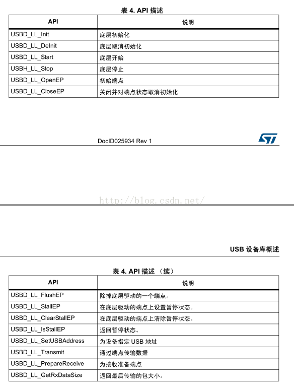

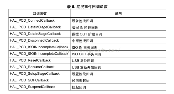

中断服务例程很简单提供了一个IRQHandler接口,通过该接口会调用一些回调函数来实现具体的处理,其中各个接口可以在库函数说明中找到,如下:
USB底层API如下:

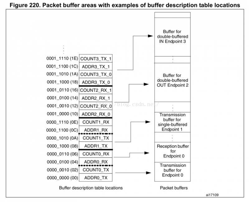

以上这些接口是需要在usbd_conf.c文件中实现的,此外还有一个USB接口的硬件IO初始化,如下:
  * @brief  Initializes the PCD MSP.
  * @param  hpcd: PCD handle
  * @retval None
void HAL_PCD_MspInit(PCD_HandleTypeDef *hpcd)
  GPIO_InitTypeDef  GPIO_InitStruct;
  /* Enable the GPIOA clock */
  __HAL_RCC_GPIOA_CLK_ENABLE();
  /* Configure USB DM/DP pins */
  GPIO_InitStruct.Pin = (GPIO_PIN_11 | GPIO_PIN_12);
  GPIO_InitStruct.Mode = GPIO_MODE_AF_INPUT;
  GPIO_InitStruct.Pull = GPIO_PULLUP;
  GPIO_InitStruct.Speed = GPIO_SPEED_HIGH;
  HAL_GPIO_Init(GPIOA, &GPIO_InitStruct);
  /* Enable USB Clock */
  __HAL_RCC_USB_CLK_ENABLE();
  /* Set USB Interrupt priority */
  HAL_NVIC_SetPriority(USB_LP_CAN1_RX0_IRQn, 7, 0);
  /* Enable USB Interrupt */
  HAL_NVIC_EnableIRQ(USB_LP_CAN1_RX0_IRQn);
  * @brief  De-Initializes the PCD MSP.
  * @retval None
void HAL_PCD_MspDeInit(PCD_HandleTypeDef *hpcd)
  /* Disable USB FS Clock */
  __HAL_RCC_USB_CLK_DISABLE();
设置USB的硬件IO口为复用模式,并设置中断优先级且使能USB中断,USB中断号有三个:USB低优先级中断(20),USB高优先级中断(19),USB唤醒中断(42),这里是使能的USB低优先级中断,所有的USB事件均可触发该中断。USB底层回调函数接口实现如下:

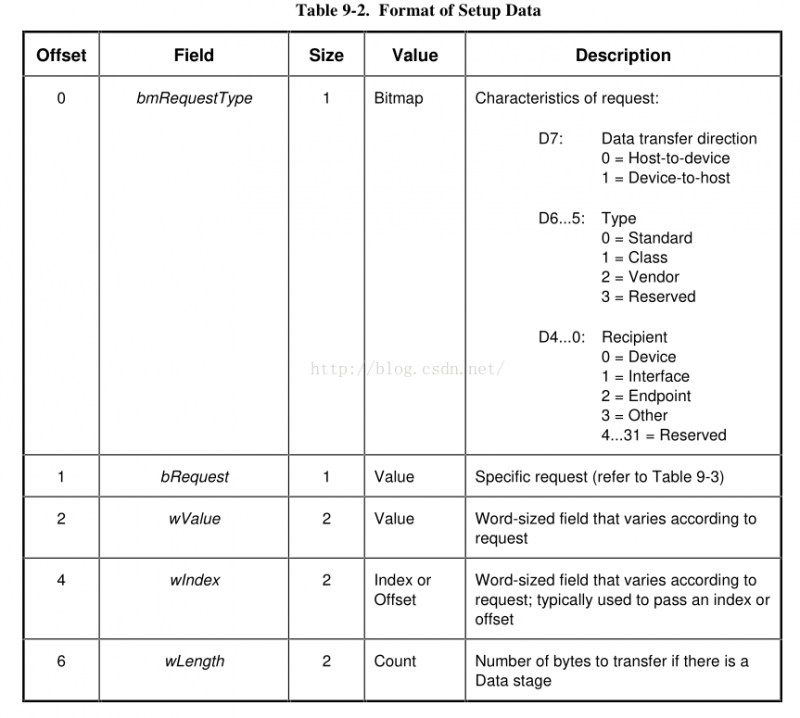

                       LL Driver Callbacks (PCD -> USB Device Library)
  * @brief  SetupStage callback.
  * @retval None
void HAL_PCD_SetupStageCallback(PCD_HandleTypeDef *hpcd)
  USBD_LL_SetupStage((USBD_HandleTypeDef*)hpcd->pData, (uint8_t *)hpcd->Setup);
  * @brief  DataOut Stage callback.
  * @param  epnum: Endpoint Number
  * @retval None
void HAL_PCD_DataOutStageCallback(PCD_HandleTypeDef *hpcd, uint8_t epnum)
  USBD_LL_DataOutStage((USBD_HandleTypeDef*)hpcd->pData, epnum, hpcd->OUT_ep[epnum].xfer_buff);
  * @brief  DataIn Stage callback.
  * @retval None
void HAL_PCD_DataInStageCallback(PCD_HandleTypeDef *hpcd, uint8_t epnum)
  USBD_LL_DataInStage((USBD_HandleTypeDef*)hpcd->pData, epnum, hpcd->IN_ep[epnum].xfer_buff);
  * @brief  SOF callback.
  * @retval None
void HAL_PCD_SOFCallback(PCD_HandleTypeDef *hpcd)
  USBD_LL_SOF((USBD_HandleTypeDef*)hpcd->pData);
  * @brief  Reset callback.
  * @retval None
void HAL_PCD_ResetCallback(PCD_HandleTypeDef *hpcd)
  USBD_LL_SetSpeed((USBD_HandleTypeDef*)hpcd->pData, USBD_SPEED_FULL);
  /* Reset Device */
  USBD_LL_Reset((USBD_HandleTypeDef*)hpcd->pData);
  * @brief  Suspend callback.
  * @retval None
void HAL_PCD_SuspendCallback(PCD_HandleTypeDef *hpcd)
  /* Inform USB library that core enters in suspend Mode */
  USBD_LL_Suspend((USBD_HandleTypeDef*)hpcd->pData);
  * @brief  Resume callback.
  * @retval None
void HAL_PCD_ResumeCallback(PCD_HandleTypeDef *hpcd)
  USBD_LL_Resume((USBD_HandleTypeDef*)hpcd->pData);
  * @brief  ISOOUTIncomplete callback.
  * @retval None
void HAL_PCD_ISOOUTIncompleteCallback(PCD_HandleTypeDef *hpcd, uint8_t epnum)
  USBD_LL_IsoOUTIncomplete((USBD_HandleTypeDef*)hpcd->pData, epnum);
  * @brief  ISOINIncomplete callback.
  * @retval None
void HAL_PCD_ISOINIncompleteCallback(PCD_HandleTypeDef *hpcd, uint8_t epnum)
  USBD_LL_IsoINIncomplete((USBD_HandleTypeDef*)hpcd->pData, epnum);
  * @brief  ConnectCallback callback.
  * @retval None
void HAL_PCD_ConnectCallback(PCD_HandleTypeDef *hpcd)
  USBD_LL_DevConnected((USBD_HandleTypeDef*)hpcd->pData);
  * @brief  Disconnect callback.
  * @retval None
void HAL_PCD_DisconnectCallback(PCD_HandleTypeDef *hpcd)
  USBD_LL_DevDisconnected((USBD_HandleTypeDef*)hpcd->pData);
每一个回调函数都是调用的usbd_core.c中的底层函数,对于不同的USB类该回调函数的接口实现是类似的,分别对应了触发USB中断的各个情况,跟串口中断不同,串口中断我们一般关心接收和发送中断即可。而USB的中断源比较多,从回调函数的个数就可以看得出来,即使这样,但这些回调函数里面有几个是为空的,如同步传输完成的回调函数以及设备连接的回调函数,此外,HAL_PCD_IRQHandler()里是没有调用同步传输完成回调函数的,在OTG模块的中断服务例程里才有调用。既然在全速模式下回调函数为空就不必刻意关注该回调函数了。重点关注Setup、DataIn、DataOut等即可,与之相关的是USB通信中的Setup阶段、数据阶段,所有的USB通信请求都是由USB主机发起,一般分为三个阶段:设置阶段、数据阶段、状态阶段。其中数据阶段是可以省略的。具体内容在后面遇到再分析,至此,USB中断底层回调函数浏览完毕,还剩下底层的设备驱动API,在分析之前需要注意两个个重要的结构体PCD_HandleTypeDef和USBD_HandleTypeDef,前者是STM32Cube库提供的跟寄存器相关的数据结构,后者是USB器件库提供的跟USB协议相关的数据结构,在例程中两者相互引用,PCD_HandleTypeDef结构如下:

一个USB总线最多可支持1128个设备,地址范围为0~127,因此这里用一个字节的dev_address来存储唯一的设备地址。而USBD_SetupReqTypedef结构体跟USB协议相关,USB协议中定义的Setup请求格式如下:
可以看到二者相匹配,获取setup请求更多详情,请参考USB2.0协议规范中第九章节。同时可以看到在USBD_HandleTypeDef结构体中包含了之前提到的描述符结构体USBD_DescriptorTypeDef,此外还包含了一个新的结构体设备类结构体USBD_ClassTypeDef,它里面是各个回调函数,在USB中断的回调函数中会调用设备类中的回调函数来实现具体功能,USB器件库手册中说明了设备类回调函数的作用,如下:

实现很简单申请一块静态空间并返回给调用者。USB设备驱动的底层API实现如下:
                       LL Driver Interface (USB Device Library --> PCD)

这些底层驱动的实现大部分都是调用Cube库中USB接口,其具体实现不必刻意关注,如果有空闲可以静心研究其寄存器的操作,我们一般只关心底层接口即可,比较复杂的一个接口是USBD_LL_Init(),USB中端点分为IN端点和OUT端点,共16个端点,在USB器件库中使用一个字节来表示,最高位为0是OUT端点,最高位为1是IN端点,USBD_LL_Init()中设置端点数为8,端点0最大包大小为64字节,为全速设备,不支持低功耗模式,并通过void指针pData来实现USBD_HandleTypeDef和PCD_HandleTypeDef结构的相互引用,HAL_PCDEx_PMAConfig()函数来设置端点缓冲区大小,这里使用了5个单向端点,有关分组缓冲的的描述可以在对应的参考手册上查找到,示例如下:
STM32中有单独的512个字节是作为USB分组缓冲区,该区域的地址为0x4000_6000~0x4000_63FF,USB和CAN模块共用该区域,因此二者不能同时访问,可以互斥访问,有关分组缓冲区有两类寄存器:USB分组缓冲区描述表地址寄存器(USB_BTABLE
);缓冲区描述表寄存器。如上图所示缓冲区描述表寄存器是几组寄存器的集合(一共8个端点共8组集合,每组里包含了4个寄存器:ADDRn_TX、COUNTn_TX、ADDRn_RX、COUNTn_RX)。这些寄存器的地址是可变的,在0x4000_6000~0x4000_63FF中,具体地址由USB_BTABLE寄存器指定,在本例中USB_BTABLE指定为0,如下:
#define BTABLE_ADDRESS                         (0x000)
/*Set Btable Address*/
USBx->BTABLE = BTABLE_ADDRESS;
对于每个端点的缓冲区地址及大小则由缓冲区描述表中的对应的4个寄存器来指定。分组缓冲区的访问是32bit的,所以虽然0x4000_0000~0x4000_63FF(共1K字节),但实际上只用了512字节。此外,这也是为何USB有两种地址表示方式,一个是USB本地地址,另一个是应用程序访问USB分组缓冲地址。在示例中设置默认的控制端点的分组大小为64字节,这也和端点0的最大包大小为64相符,且都是使用的单缓冲端点,至此,usbd_conf文件分析完毕。
