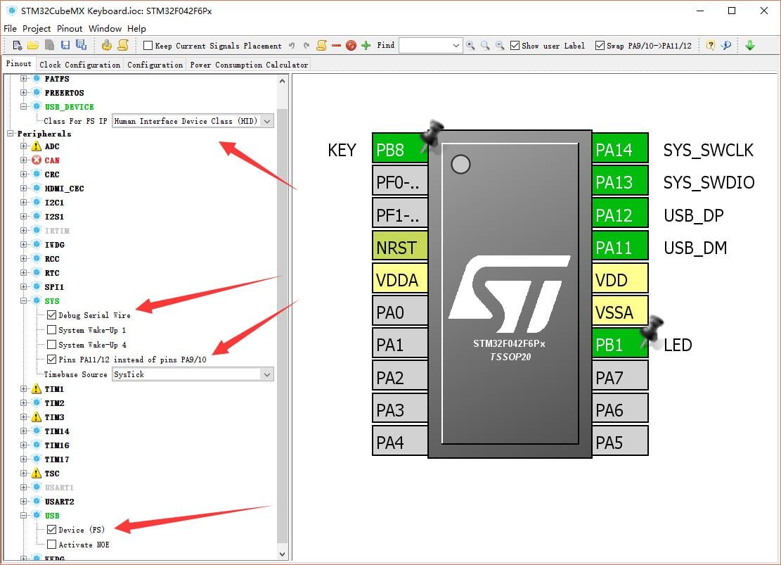

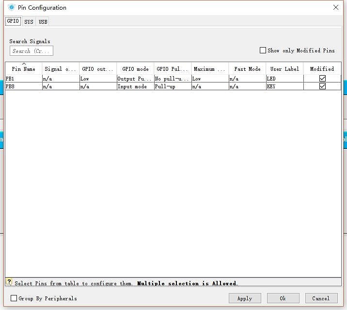

不多说,开始配置,打开STM32CubeMX,选择STM32F042F6P6芯片,开启pin脚映射,打开USB设备,选择USB设备为HID,设置按键和LED对应引脚的输入输出模式:
配置按键和LED引脚的状态及备注名:

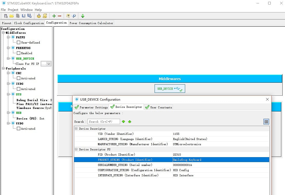

可以在此修改USB设备名称、厂家、PIDVID等:

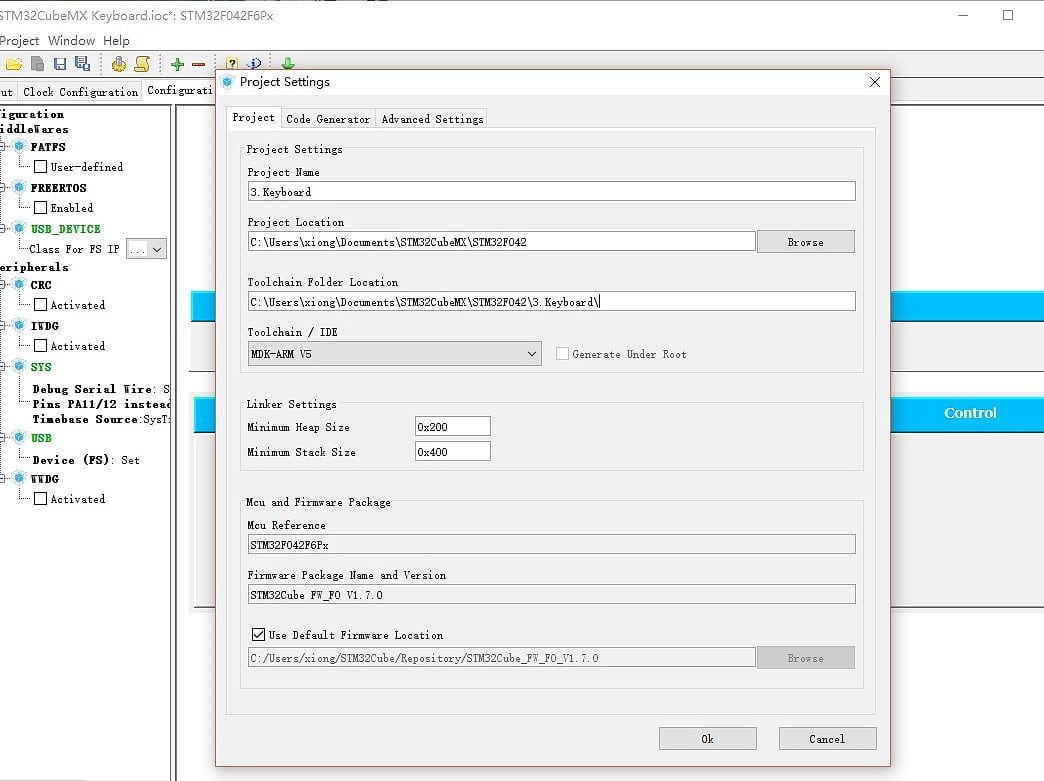

配置工程输出参数,然后生成并打开工程:

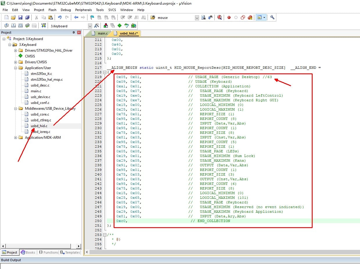

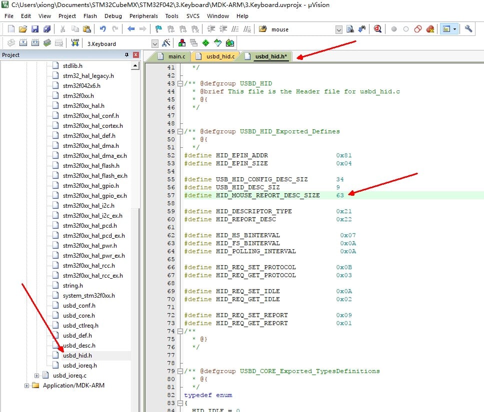

按图中所示打开usbd_hid.c文件,找到HID_MOUSE_ReportDesc数组定义处(默认生产HID设备为Mouse,这里数组名不影响,只要里面的描述符是键盘的就行),修改成如下数据:
 0x05, 0x01, // USAGE_PAGE (Generic Desktop) //63
 0x09, 0x06, // USAGE (Keyboard)
 0xa1, 0x01, // COLLECTION (Application)
 0x05, 0x07, // USAGE_PAGE (Keyboard)
 0x19, 0xe0, // USAGE_MINIMUM (Keyboard LeftControl)
 0x29, 0xe7, // USAGE_MAXIMUM (Keyboard Right GUI)
 0x15, 0x00, // LOGICAL_MINIMUM (0)
 0x25, 0x01, // LOGICAL_MAXIMUM (1)
 0x75, 0x01, // REPORT_SIZE (1)
 0x95, 0x08, // REPORT_COUNT (8)
 0x81, 0x02, // INPUT (Data,Var,Abs)
 0x95, 0x01, // REPORT_COUNT (1)
 0x75, 0x08, // REPORT_SIZE (8)
 0x81, 0x03, // INPUT (Cnst,Var,Abs)
 0x95, 0x05, // REPORT_COUNT (5)
 0x05, 0x08, // USAGE_PAGE (LEDs)
 0x19, 0x01, // USAGE_MINIMUM (Num Lock)
 0x29, 0x05, // USAGE_MAXIMUM (Kana)
 0x91, 0x02, // OUTPUT (Data,Var,Abs)
 0x75, 0x03, // REPORT_SIZE (3)
 0x91, 0x03, // OUTPUT (Cnst,Var,Abs)
 0x95, 0x06, // REPORT_COUNT (6)
 0x25, 0x65, // LOGICAL_MAXIMUM (101)
 0x19, 0x00, // USAGE_MINIMUM (Reserved (no event indicated))
 0x29, 0x65, // USAGE_MAXIMUM (Keyboard Application)
 0x81, 0x00, // INPUT (Data,Ary,Abs)
 0xc0, // END_COLLECTION
再打开usbd_hid.h文件,修改HID_MOUSE_REPORT_DESC_SIZE的值为63.

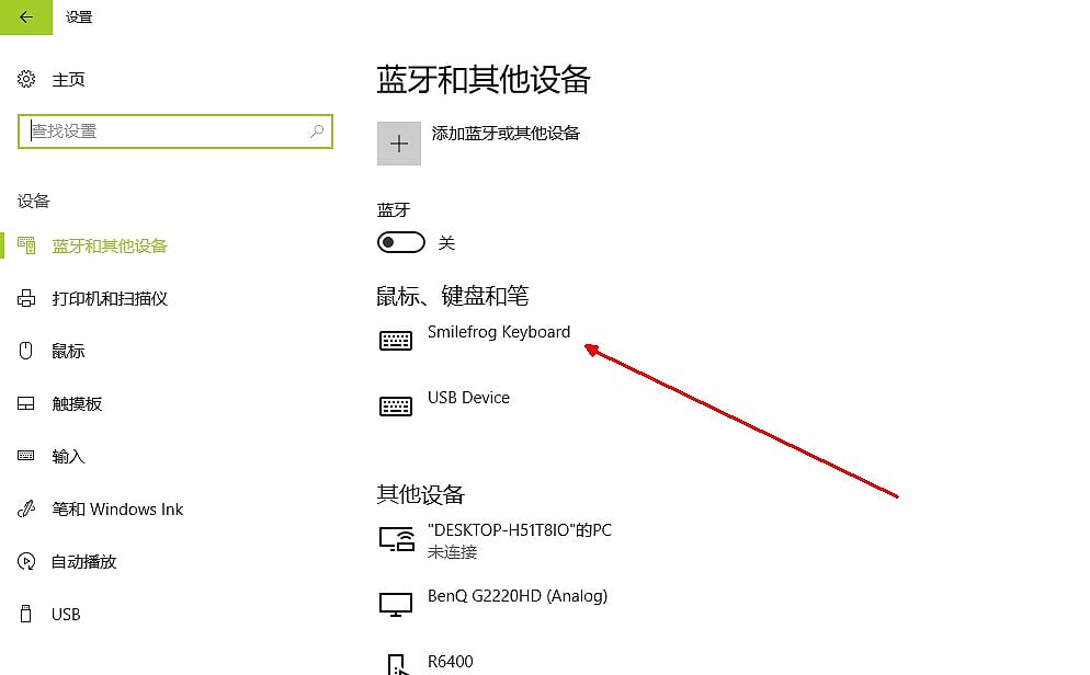

编译工程,下载到板子上,插上USB线连接到电脑上,是不是识别出为键盘设备了呢?

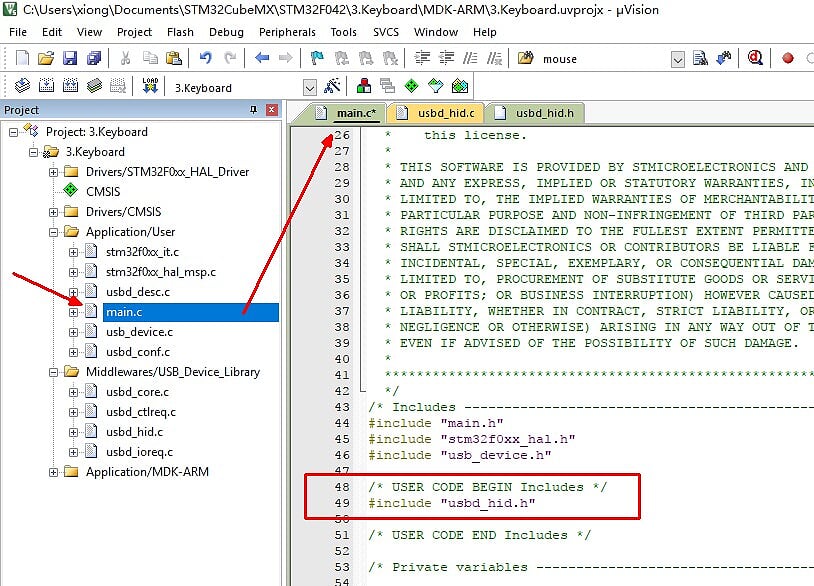

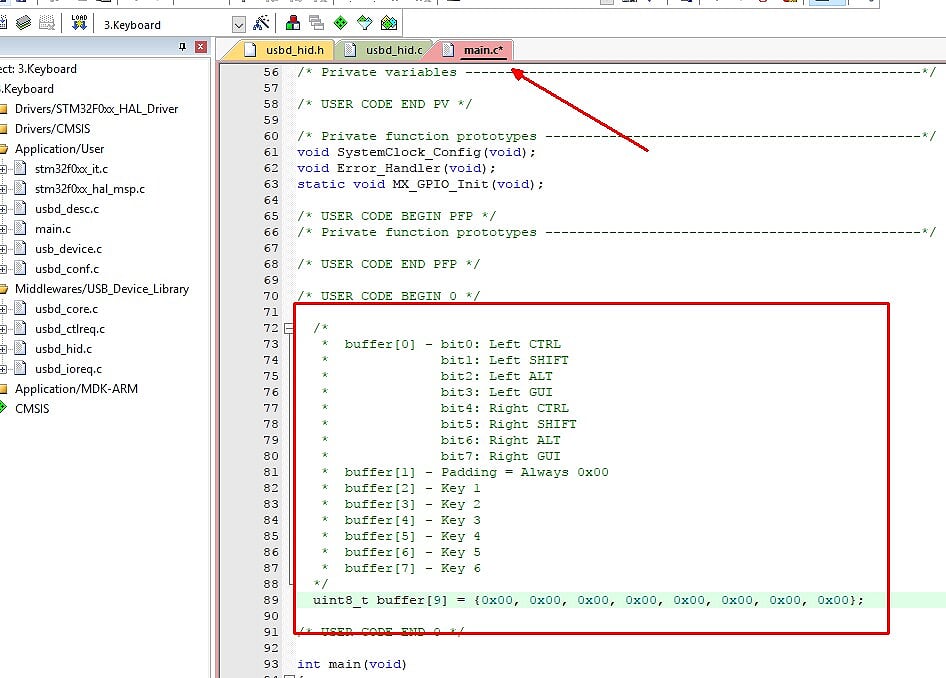

继续修改main.c文件,添加头文件
#include "usbd_hid.h"
添加一个数组变量,用于传输键盘参数的,byte0是传控制键;byte1是保留键,不用改;byte3~byte7都可以存放传输的按键值
 * buffer[0] - bit0: Left CTRL
 *           -bit1: Left SHIFT
 *           -bit2: Left ALT
 *           -bit3: Left GUI
 *           -bit4: Right CTRL
 *           -bit5: Right SHIFT
 *           -bit6: Right ALT
 *           -bit7: Right GUI
 * buffer[1] - Padding = Always 0x00
 * buffer[2] - Key 1
 * buffer[3] - Key 2
 * buffer[4] - Key 3
 * buffer[5] - Key 4
 * buffer[6] - Key 5
 * buffer[7] - Key 6
 uint8_t buffer[9] = {0x00, 0x00, 0x00, 0x00, 0x00, 0x00, 0x00, 0x00};

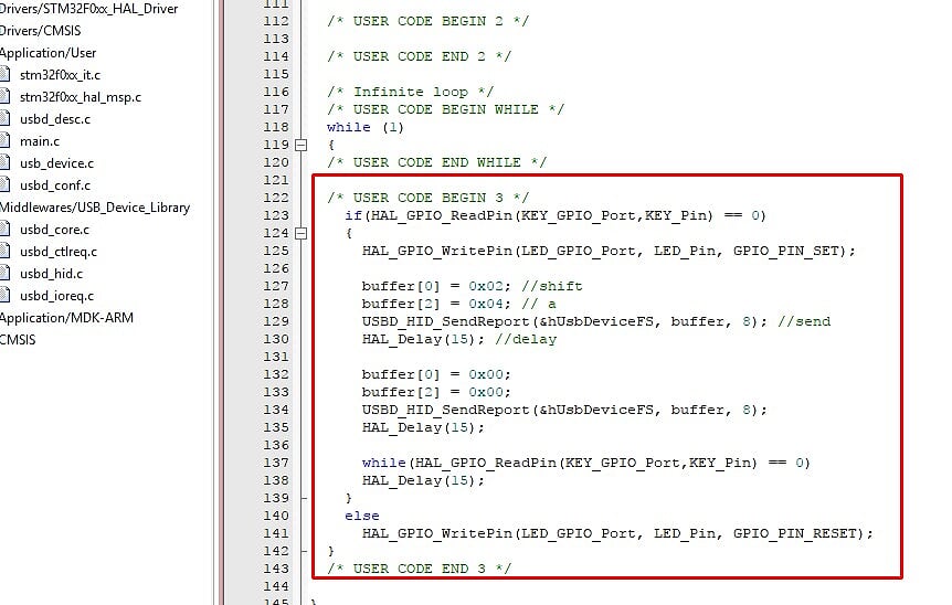

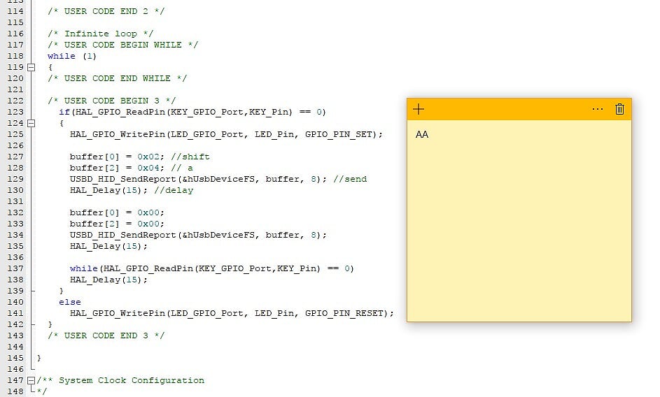

添加按键检测及传输键值到电脑的代码:
 if(HAL_GPIO_ReadPin(KEY_GPIO_Port,KEY_Pin) == 0)
  HAL_GPIO_WritePin(LED_GPIO_Port, LED_Pin, GPIO_PIN_SET);
  buffer[0] = 0x02; //shift
  buffer[2] = 0x04; // a
  USBD_HID_SendReport(&hUsbDeviceFS, buffer, 8); //send
  HAL_Delay(15); //delay
  buffer[0] = 0x00;
  buffer[2] = 0x00;
  HAL_Delay(15);
  while(HAL_GPIO_ReadPin(KEY_GPIO_Port,KEY_Pin) == 0)
  HAL_Delay(15);
 else
  HAL_GPIO_WritePin(LED_GPIO_Port, LED_Pin, GPIO_PIN_RESET);

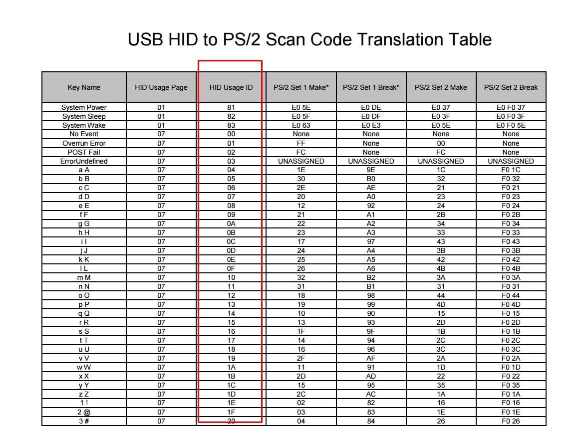

对应键值可和此文件中的HID Usage ID对应,是16进制(如字符‘a’对应键值为0x04),pdf文件在附件中有(USB_HIDtoKBScanCodeTranslationTable.pdf):
再编译文件下载到板子上,试试按下按键时是不是在电脑上就输入了一个大写的‘A’呢?
