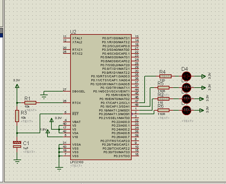

2019年10月24日 | LPC2124流水灯及闪烁灯proteus仿真和源码
2019-10-24 来源:51hei
分享一个LPC2124芯片做的流水灯及闪烁灯的proteus仿真,下面是原理图:
源码:
/****************************************Copyright (c)**************************************************
**                               Guangzou ZLG-MCU Development Co.,LTD.
**                                      graduate school
**--------------File Info-------------------------------------------------------------------------------
** File name:                        main.c
** Last modified Date:  2004-09-16
** Last Version:                1.0
** Descriptions:                The main() function example template
** Created by:                        Chenmingji
** Created date:                2004-09-16
** Version:                                1.0
** Descriptions:                The original version
** Modified by:
** Modified date:
** Version:
** Descriptions:
#include"config.h"
/*延时子函数*/
void  delay(uint32 z)
        uint32  i;
        for(;z>0;z--)
                for(i=0;i<50000;i++);
/*初始化IO口子程序*/
void  sys_init()
        PINSEL0=0X00000000;
        PINSEL1=0X00000000;//所有半端口接到GPIO
        IO0DIR=1<<17|1<<18|1<<19|1<<20;//设为输出方式
        IO0SET=1<<17|1<<18|1<<19|1<<20;//设为高电平
//*主程序*/
int  main()
        sys_init();//调用初始化IO口子程序
        while(1)
                IO0CLR=1<<17;//输出低电平
                delay(20);
                IO0SET=1<<17;//输也高电平
                delay(20);
                IO0CLR=1<<18;
                delay(20);
                IO0SET=1<<18;
                delay(20);
                IO0CLR=1<<19;
                delay(20);
                IO0SET=1<<19;
                delay(20);
                IO0CLR=1<<20;
                delay(20);
                IO0SET=1<<20;
                delay(20);
