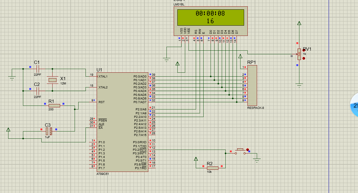

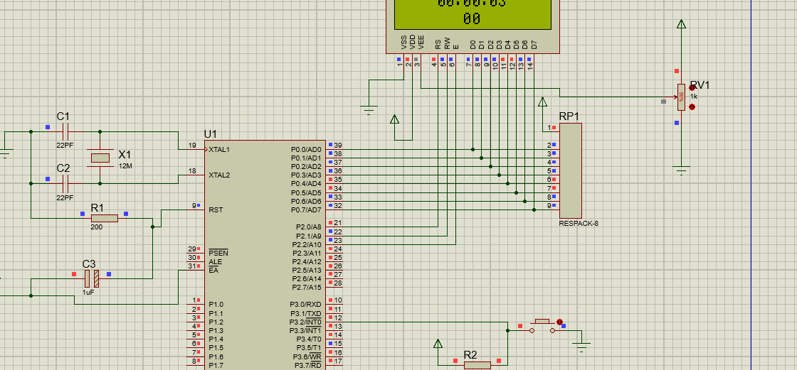

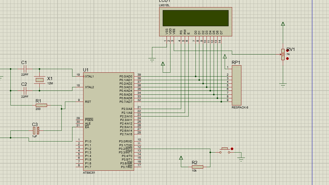

出租车计费仿真原理图如下
单片机源程序如下:
#include
#include
unsigned code num[]={0x30,0x31,0x32,0x33,0x34,0x35,0x36,0x37,0x38,0x39};
unsigned char data x_pos, y_pos;
sbit rs=P2^0;
sbit  rw=P2^1;
sbit  e=P2^2;
sbit Control=P3^5;
bit  swit_flg=0;
unsigned char time,minte,second;
unsigned char result;
void delay_ms(unsigned char ms)
{   unsigned int i,j;
    for(i=ms;i>0;i--)
          for(j=200;j>0;j--);
          for(j=102;j>0;j--);
void busy(void)
    unsigned char i;
        P0=0xff;
        rs=0;
        rw=1;
        e=1;
        for(i=0;i<20;i++)
           if((P0&0x80)==0) break;
        e=0;
void  LcdWD(unsigned char d)
    busy();
        rs=1;
        rw=0;
        P0=d;
        e=1;
        _nop_();
        e=0;
void LcdWC(unsigned char c)
    busy();
        rs=0;
        rw=0;
        P0=c;
    e=1;
        _nop_();
        e=0;
void LcdInit(void)
    LcdWC(0x38);     //显示模式设置
        delay_ms(3);         //延时3ms
    LcdWC(0x38);
        delay_ms(3);
        LcdWC(0x38);
        delay_ms(3);
        LcdWC(0x38);
        delay_ms(3);
        LcdWC(0x08);   //显示关闭
        LcdWC(0x01);   //清屏
        delay_ms(3);
        LcdWC(0x06);   //显示光标移动设置
        LcdWC(0x0c);   //开显示及   光标设置
void charlcdpos(unsigned char x,unsigned char y)
    x_pos=x;
        y_pos=y;
        x_pos&=0x0f;
        y_pos&=0x01;
        if(y_pos==0)  LcdWC(x_pos|0x80);           //  写第一行命令
        else    LcdWC(x_pos|0xc0);                           //  写第二行命令
void putchar(unsigned char x,unsigned char y,unsigned char c)
    charlcdpos(x,y);
        LcdWD(c);
void charcursornext(void)
    x_pos++;
        if(x_pos>15)
           x_pos=0;
           y_pos++;
           y_pos&=0x1;
void  displayInit(void)
{  unsigned char tmp;
                    tmp=time/10;putchar(4,0,num[tmp]);
                        tmp=time%10;putchar(5,0,num[tmp]);        putchar(6,0,0x3a);
                        tmp=minte/10;putchar(7,0,num[tmp]);
                        tmp=minte%10;putchar(8,0,num[tmp]);        putchar(9,0,0x3a);
                        tmp=second/10;putchar(10,0,num[tmp]);
                        tmp=second%10;putchar(11,0,num[tmp]);
                        tmp=result/10; putchar(7,1,num[tmp]);
                        tmp=result%10;putchar(8,1,num[tmp]);
void IRS_EX0() interrupt 0 using 1
        if(swit_flg==0)
        {        time=0;
                minte=0;
                second=0;
                result=0;
                swit_flg=1;
                ET0=1;
                ET1=1;
                TR0=1;
            TR1=1;
        else if(swit_flg==1)
        {        result=(minte*60+second)*2;
            swit_flg=0;
                ET0=0;
                ET1=0;
void  IRS_T0() interrupt 1 using 2
        Control=1;
        TH0=0XD8;
        TL0=0XF0;
        Control=0;
void  ISR_T1() interrupt 3 using 2
        second++;
                if(second>=60)
                {        second=0;
                        minte++;
                if(minte>=60)
                {        minte=0;
                        time++;
                if(time>=24) time=0;
void init_TC()
        TMOD=0X61;
        TH0=0Xd8;  //
        TL0=0Xf0;
        TL1=0XbC;//TL1=0X9C;
        TH1=0XbC;
        //IE=0X8A;
        Control=0;
//   TR0=1;
//        TR1=1;
void init_EX0()
        IT0=1;
        EX0=1;
        EA=1;
void main()
        LcdInit();
        displayInit();
        delay_ms(100);
        init_TC();
        init_EX0();
        while(1)
