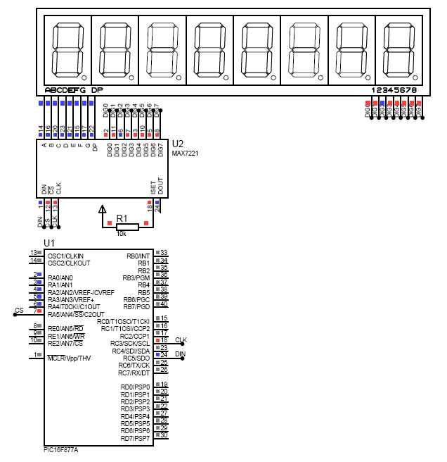

2019年10月28日 | PIC单片机电子钟程序+仿真电路
2019-10-28 来源:51hei
#include
#define uchar unsigned char
#define uint unsigned int
#define CS RA5
uchar secs = 0;
uchar minutes = 0;
uchar hours = 0;
unsigned char disbuf[8] = {1,2,3,4,5,6,7,8};
void delay_ms(uint n)
        uchar i;
        while(n--)
                for(i=0;i<100;i++);
void Port_Initial(void)
        TRISC = 0xD7;
        PORTC = 0x00;
        TRISA = 0x00;
        PORTA = 0x00;
void Time0_Initial(void)
        T0CS = 0;
        PSA = 1;
        T0IF = 0;
        T0IE = 1;
        GIE = 1;
        TMR0 = 0x00;
volatile unsigned int cnt = 0;
void interrupt ISR(void)
        TMR0 = 0x13;
        T0IF = 0;
        CLRWDT();
        cnt ++;
        if(cnt==500)
                cnt = 0;
                secs ++;
        if(secs==60)
                secs = 0;
                minutes ++;
        if(minutes==60)
                minutes = 0;
                hours ++;
        if(hours==24)
                hours = 0;
void SPI_Initial(void)
        PIR1 = 0;
        SSPCON = 0x30;
        SSPSTAT = 0x00;
void Display(uchar *str)
        uchar i;
        for(i=0;i<8;i++)
                MAX7221_WRITE(i+1,str[i]);
void HEXTOBCD(void)
        disbuf[0] = hours/10;
        disbuf[1] = hours%10;
        disbuf[2] = 10;
        disbuf[3] = minutes/10;
        disbuf[4] = minutes%10;
        disbuf[5] = 10;
        disbuf[6] = secs/10;
        disbuf[7] = secs%10;
void main()
        SPI_Initial();
        delay_ms(10);
        Port_Initial();
        delay_ms(10);
        Time0_Initial();
        delay_ms(10);
        MAX7221_Initial();
        delay_ms(10);
        while(1)
                HEXTOBCD();
                delay_ms(10);
                Display(disbuf);
                delay_ms(10);
