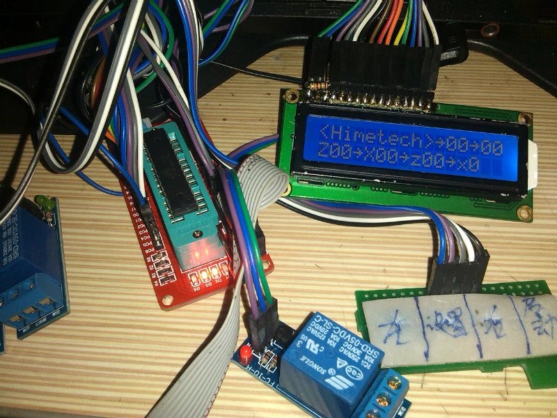

2019年11月13日 | avr继电器+1602程序
2019-11-13 来源:51hei
#include
#include
#define  uchar unsigned char
#define  uint unsigned int
#define  rs_L     PORTD&=~BIT(0)
#define  rs_H     PORTD|=BIT(0)
#define  rs_out   DDRD|=BIT(0)
#define  rw_L     PORTD&=~BIT(1)
#define  rw_H     PORTD|=BIT(1)
#define  rw_out   DDRD|=BIT(1)
#define  en_L     PORTD&=~BIT(2)
#define  en_H     PORTD|=BIT(2)
#define  en_out   DDRD|=BIT(2)
#define  s1_L     PORTD&=~BIT(4)
#define  s1_H     PORTBD|=BIT(4)
#define  s1_out   DDRD|=BIT(4)
#define  s2_L     PORTD&=~BIT(5)
#define  s2_H     PORTD|=BIT(5)
#define  s2_out   DDRD|=BIT(5)
#define  s3_L     PORTD&=~BIT(6)
#define  s3_H     PORTD|=BIT(6)
#define  s3_out   DDRD|=BIT(6)
#define  s4_L     PORTD&=~BIT(7)
#define  s4_H     PORTD|=BIT(7)
#define  s4_out   DDRD|=BIT(7)
uchar miu=0;
signed char t,tt,z,zz,a,b,c,d,e,f,g;
uchar table1[]="~00~00";
uchar table2[]="Z00~X00~z00~x0  ";
const table3[10]={20,40,60,80,100,120,140,160,180,200};
void delay(uint ms)//yan shi han shu
uchar a;
uint b;
for(a=0;afor(b=0;b<1141;b++);
uchar key_press()//pan dan an jian shi fu an xia
    uchar j;
    DDRC|=0X0f;
        PORTC|=0X0f;
        DDRC&=0XF0;
        j=PINC;
        j=j&0X0F;//00001111
        if(j==0X0F)
          return 0;
        else
         return 1;
void key_scan()//pan dan an xia de  jian
    uchar key;
    delay(10);
        if(key_press())
        key=PINC;
        key&=0X0F;
        switch(key)
           case 0X0E: //guang biao zuo yi
                      zhilin(0x0f);
                      miu--;
              if(miu==1){zhilin(0x80+11);}
                      if(miu==2){zhilin(0x80+12);}
                          if(miu==3){zhilin(0x80+14);}
                          if(miu==4){zhilin(0x80+15);}
                  if(miu==5){zhilin(0x80+0x40+1);}
                      if(miu==6){zhilin(0x80+0x40+2);}
                          if(miu==7){zhilin(0x80+0x40+5);}
                          if(miu==8){zhilin(0x80+0x40+6);}
                          if(miu==9){zhilin(0x80+0x40+9);}
                          if(miu==10){zhilin(0x80+0x40+10);}
                          if(miu==11){zhilin(0x80+0x40+13);}
                          if(miu==-1){miu=12;}
                   }break;
                   case 0X0B: //guang biao you yi
                      zhilin(0x0f);
                      miu++;
                          if(miu==12){miu=0;}
                   }break;
           case 0X0D://dui guang biao suo zai xiang, jin xin jia shu
                          if(miu==1){t++;if(t==2)t=0;zhilin(0x0c);dizhishujv((0x80+11),(0x30+t));}
                      if(miu==2){tt++;if(tt==10)tt=0;zhilin(0x0c);dizhishujv((0x80+12),(0x30+tt));}
                          if(miu==3){z++;if(z==2)z=0;zhilin(0x0c);dizhishujv((0x80+14),(0x30+z));}
                          if(miu==4){zz++;if(zz==2)zz=0;zhilin(0x0c);dizhishujv((0x80+15),(0x30+zz));}
                      if(miu==5){a++;if(a==2)a=0;zhilin(0x0c);dizhishujv((0x80+0x40+1),(0x30+a));}
                      if(miu==6){b++;if(b==10)b=0;zhilin(0x0c);dizhishujv((0x80+0x40+2),(0x30+b));}
                      if(miu==7){c++;if(c==2)c=0;zhilin(0x0c);dizhishujv((0x80+0x40+5),(0x30+c));}
                      if(miu==8){d++;if(d==10)d=0;zhilin(0x0c);dizhishujv((0x80+0x40+6),(0x30+d));}
                      if(miu==9){e++;if(e==2)e=0;zhilin(0x0c);dizhishujv((0x80+0x40+9),(0x30+e));}
                          if(miu==10){f++;if(f==10)f=0;zhilin(0x0c);dizhishujv((0x80+0x40+10),(0x30+f));}
                      if(miu==11){g++;if(g==2)g=0;zhilin(0x0c);dizhishujv((0x80+0x40+13),(0x30+g));}
           }break;
           case 0X07:
                   DDRC&=~BIT(4);
                   PORTC|=BIT(4);
                   //ji qi shi xv
           if(t)PORTD|=BIT(6);else PORTD&=~BIT(6);//qi
         if(z)PORTD|=BIT(7);else PORTD&=~BIT(7);//zhu zhou
           if(a){PORTD|=BIT(4); }else PORTD&=~BIT(4);//z  zou en
            delay(table3);
           if(c)PORTD|=BIT(5);else PORTD&=~BIT(5);   //x zou en
           while(PINC&0x10);
           delay(table3[d]);
