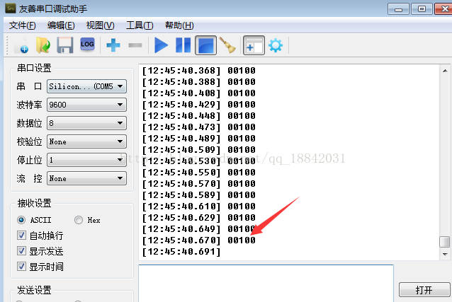

2019年11月25日 | STM8S103之tim2捕获周期
2019-11-25 来源:eefocus
1.系统时钟初始化为内部16M
CLK_HSIPrescalerConfig(CLK_PRESCALER_HSIDIV1);    //时钟   初始化时钟为1分频 16M   2分频8M
2.初始化定时器2设置PD3为捕获输入
void Init_Timer2(void)
    GPIO_Init(GPIOD, GPIO_PIN_3, GPIO_MODE_IN_FL_NO_IT);//输入  无中断
    TIM2_DeInit();
    TIM2_TimeBaseInit(TIM2_PRESCALER_16, 10000-1);           //16分频, 1MHZ 10000 = 10ms 溢出
    TIM2_ICInit(TIM2_CHANNEL_2, TIM2_ICPOLARITY_RISING, TIM2_ICSELECTION_DIRECTTI, TIM2_ICPSC_DIV1, 0x00); //设置通道 设置输入捕获上升触发  捕获输入引脚  输入捕捉预定标器    滤波
    TIM2_ClearFlag(TIM2_FLAG_CC2);                         //指定要清除的标志
    TIM2_ITConfig(TIM2_IT_UPDATE, ENABLE);                 //使能向上计数功能
    TIM2_ITConfig(TIM2_IT_CC2, ENABLE);                    //使能输入捕获通道2
    TIM2_Cmd(ENABLE);
3.编写主函数
 void main(void)
  CLK_HSIPrescalerConfig(CLK_PRESCALER_HSIDIV1);    //内部时钟16M
  Init_UART1();
  Init_Timer2();
  enableInterrupts();
  while(1);
4、编写中断服务函数
uint8_t fet;
 INTERRUPT_HANDLER(TIM2_UPD_OVF_BRK_IRQHandler, 13)
   fet++;
  TIM2_ClearITPendingBit(TIM2_IT_UPDATE);
  /* In order to detect unexpected events during development,
     it is recommended to set a breakpoint on the following instruction.
  * @brief Timer2 Capture/Compare Interrupt routine.
  * @param  None
  * @retval None
 INTERRUPT_HANDLER(TIM2_CAP_COM_IRQHandler, 14)
  if(TIM2_GetITStatus(TIM2_IT_CC2) != RESET) //如果CH2边沿触发
    static uint8_t buf[12];
    static uint16_t set_num1,set_num2;
    static uint8_t timer1,timer2;
    static uint8_t num;
    uint8_t len = 0;
    uint16_t fre = 0;
    num++;
    if(num == 1)
      set_num1 = TIM2_GetCapture2();
      timer1 = fet;
    else if(num == 2)
      num = 0;
      set_num2 = TIM2_GetCapture2();
      timer2 = fet;
      fet = 0;
      fre = 1000000 / ((timer2*10000+set_num2) - (timer1*10000+set_num1));
      buf[len++]=fre/10000%10+'0';
      buf[len++]=fre/1000%10+'0';
      buf[len++]=fre/100%10+'0';
      buf[len++]=fre/10%10+'0';
      buf[len++]=fre%10+'0';
      buf[len++]= 'n';
      UART1_Send(buf,6);
  TIM2_ClearITPendingBit(TIM2_IT_CC2);
5、结果
输出100Hz,实验成功。
