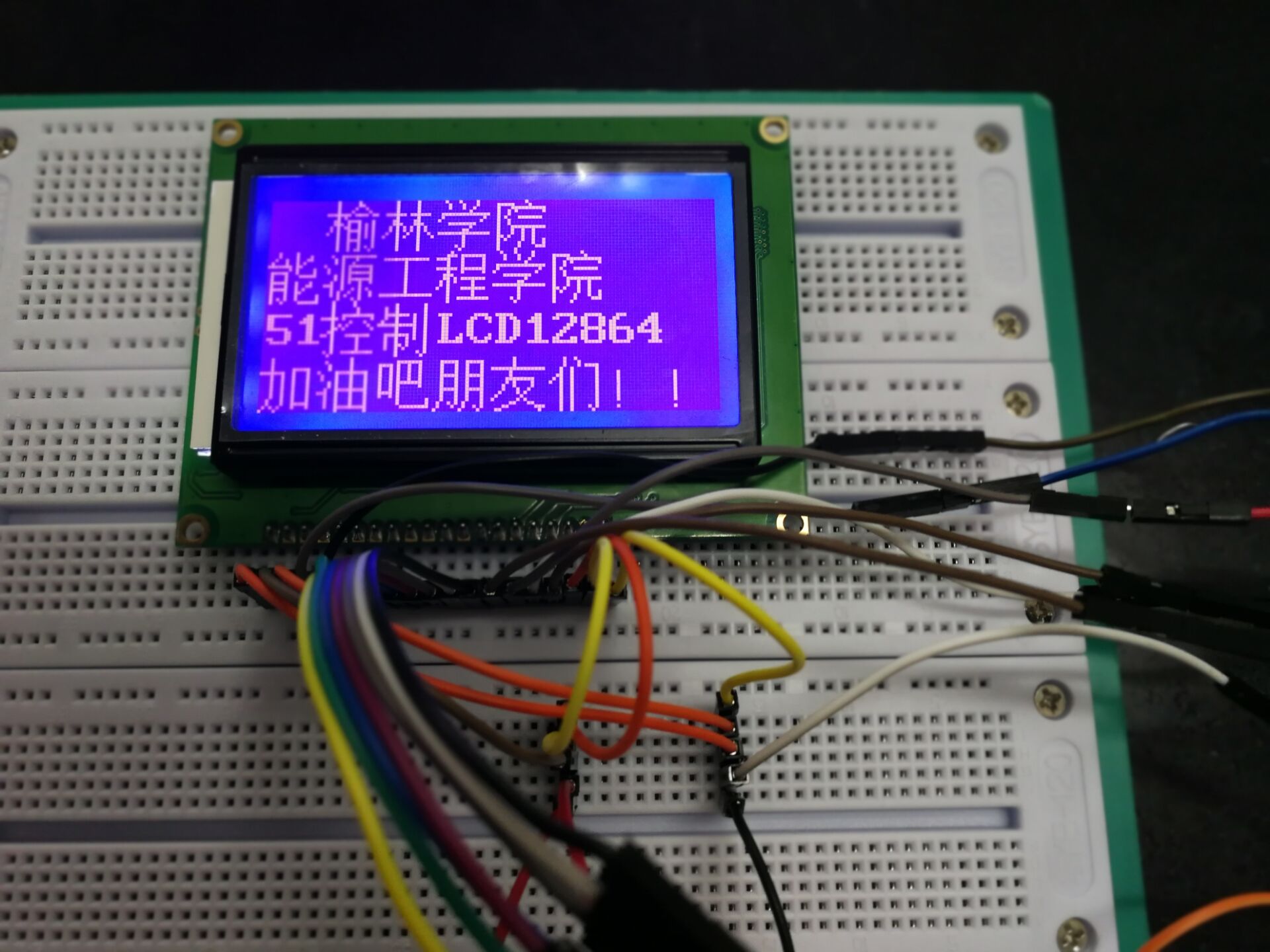

2019年11月26日 | 51单片机控制LCD12864显示汉字
2019-11-26 来源:51hei
程序:
#include
#define DATA_PORT P0
sbit LCD12864_EN   = P1^2;
sbit LCD12864_RSET = P1^3;
sbit LCD12864_RS   = P1^0;
sbit LCD12864_RW   = P1^1;
sbit LCD12864_PSB  = P1^6;
void delay(unsigned int xms)  //延时//
        unsigned char i,j;
        for(j = 0; j < xms; j++)
                for(i = 0;i < 110;i++);
bit LcdBusyCheck(){
          bit result;
          LCD12864_RS = 0;
          LCD12864_RW = 1;
          LCD12864_EN = 1;
          result = (bit)(DATA_PORT&0x80);
          LCD12864_EN = 0;
          return result;
void WriteCmdToLCD(unsigned char cmd)
                //        while(LcdBusyCheck());
        delay(10);
          LCD12864_RS = 0;
          LCD12864_RW = 0;
          LCD12864_EN = 1;
          DATA_PORT = cmd;
          delay(5);
        LCD12864_EN = 0;
        delay(5);
        LCD12864_EN = 1;
void WriteDatToLcd(unsigned char dat)
                //while(LcdBusyCheck());
                delay(10);
                LCD12864_RS = 1;
          LCD12864_RW = 0;
          LCD12864_EN = 1;
          DATA_PORT = dat;
          delay(5);
        LCD12864_EN = 0;
        delay(5);
        LCD12864_EN = 1;
void WriteStrToLcd(unsigned char *str)
        while(*str != '')
                WriteDatToLcd(*str++);
                delay(5);
void LcdPos(unsigned char x,unsigned char y)
        unsigned char pos;
        if(x == 1)
                x = 0x80;
        }else if(x == 2)
                x = 0x90;
        }else if(x == 3)
                x = 0x88;
        }else if(x == 4)
                x = 0x98;
        pos = x + y - 1;
        WriteCmdToLCD(pos);
void LcdInit()
        LCD12864_PSB = 1;
         LCD12864_RSET = 0;
         delay(10);
        LCD12864_RSET = 1;
        WriteCmdToLCD(0x30);
        delay(5);
        delay(5);
        WriteCmdToLCD(0x18);
        delay(5);
        WriteCmdToLCD(0x10);
        delay(5);
        WriteCmdToLCD(0x01);
        delay(5);
        WriteCmdToLCD(0x06);
        delay(5);
         WriteCmdToLCD(0x0c);
        delay(5);
int main()
                P0 = 0xff;
                P1 = 0xff;
           LcdInit();
           while(1)
                     LcdPos(1,1);
                         WriteStrToLcd("  榆林学院  ");
                        delay(5);
                LcdPos(2,1);
                         WriteStrToLcd("能源工程学院");
                        delay(5);
                LcdPos(3,1);
                         WriteStrToLcd("51控制LCD12864");
                        delay(5);
                LcdPos(4,1);
                         WriteStrToLcd("加油吧朋友们!!!");
                        delay(500);
