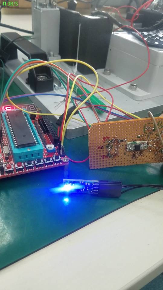

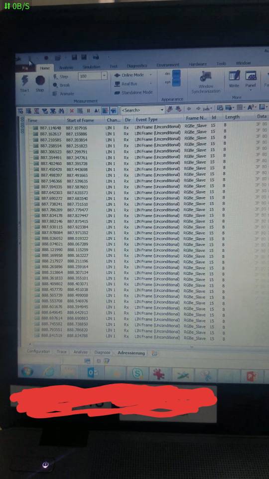

LIN mater的51单片机代码
/**************master*****************/
#include
#include
sbit  p31=P3^1;
sbit  k1=P1^0;
sbit  k2=P1^1;
sbit  p20=P2^0;
unsigned char t;
unsigned char sendflag, flag;
void delay(unsigned int i)
   while(i--);
void send()
                                      //           同步   ID   data1 data2 data3 data4 data5 data6 data7 data8  checksum
            unsigned char code table1[11]={0x55, 0x55, 0x3f, 0x80 ,0x00 ,0x00 ,0xff ,0x64 ,0x10 , 0xfc ,  0x79  };
            unsigned char code table2[11]={0x55, 0x55, 0x3f, 0x80 ,0x00 ,0xff ,0x00 ,0x64 ,0x10 , 0xfc ,  0x79  };
          /*  发送一帧报文    */
         unsigned char i ;
             p31=0;        //间歇场
             delay(96);        //96
             p31=1;
                delay(2);
                //_nop_();         _nop_(); _nop_();
              for(i=0;i<11;i++)
                    if(flag==1)
                     SBUF=table1[i];
                    if(flag==2)
                        SBUF=table2[i];
                    while(TI==0);
                    TI=0;
void delayms(unsigned int x)  //报文间隔发送延时
  unsigned int i;
unsigned char j;
  for(i=0;i    for(j=0;j<122;j++);
void init(void)
         /*******19.2k波特率****** */
            SCON=0x50;           //串口方式1 8个数据位
         TMOD=0x20;
     PCON=0x80;        //0x80=19.2k/s
         TH1 =TL1 = 0xfd;
        // ES=1;                                                                                                                                                                                             //串行中断允许
         TR1=1; //启动定时器1
     EA= 1;
            IP=0x10;//串口中断优先
void main()
          init();
          flag=1;
          while(1)
           P2=0xFE;
           P0=0x92;
           send();
         /*  发送完成    */
            delayms(200) ;          //发送间隔周期
                   if(k1==0)
                  while(k1==0);
                  flag=1;
                if(k2==0)
                    while(k2==0); //抬键程序才往下执行
                  flag=2;
