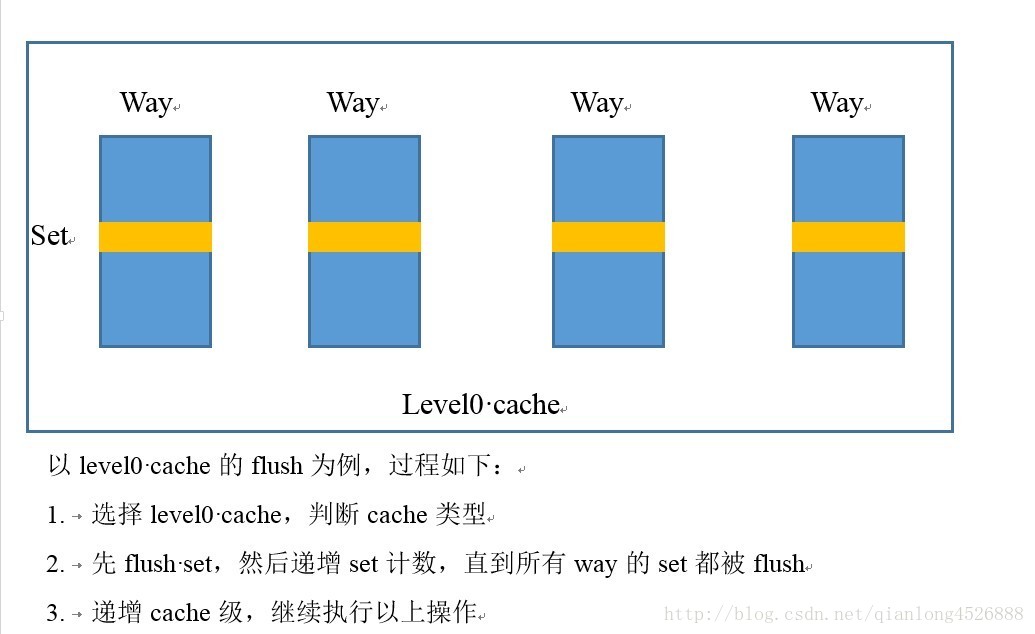

 *  __flush_dcache_all()
*  Flush the wholeD-cache.
 * Corrupted registers: x0-x7, x9-x11
ENTRY(__flush_dcache_all)
//保证之前的访存指令的顺序
    dsb sy
      //读cache level id register
    mrs x0, clidr_el1           // read clidr
      //取bits[26:24](Level of Coherency for the cache hierarchy.)
//需要遵循cache一致性的cache层级(例如有3级cache,但2级需要做一致性)
    and x3, x0, #0x7000000      // extract loc from clidr
      //逻辑右移23位,把bits[26:24]放到bits[2:0]
    lsr x3, x3, #23         // left align loc bit field
      //如果需要做cache一致性的层级为0,则不需要flush,跳转到finished标记处。
    cbz x3, finished            // if loc is 0, then no need toclean
      //x10存放cache级,从level0 cache开始做flush
      //以下三个循环loop3是set/way(x9),
//loop2是index(x7),loop1是cache level(x10)
    mov x10, #0             // start clean at cache level 0
loop1:
//x10+2后右移一位正好等于1,再加上x10本身正好等于3
      //每执行一次loop1,x2+3*执行次数,目的在于把x0(clidr_el1)右移3位,
//取下一个cache的ctype type fields字段,clidr_el1的格式见《ARMv8 ARM》
    add x2, x10, x10, lsr #1        /
      //x0逻辑右移x2位,给x1,提取cache类型放到x1中,x0中存放:clidr_el1
    lsr x1, x0, x2
      //掩掉高位,只取当前cache类型
    and x1, x1, #7
      /* 判断当前cache是什么类型:
* 000  No cache.
* 001  Instruction cache only.
* 010  Data cache only.
* 011  Separate instruction and data caches.
* 100  Unified cache.
      //小于2说明data cache不存在或者只有icache,
//跳转skip执行,大于等于2继续执行
    cmp x1, #2
    b.lt   skip
 *  Save/disableand restore interrupts.
 * .macro save_and_disable_irqs, olddaif
 * mrs olddaif,daif
 * disable_irq
 * .endm
      //保存daif到x9寄存器中,关闭中断
    save_and_disable_irqs x9        // make CSSELR and CCSIDR access atomic
      //选择当前cache级进行操作,csselr_el1寄存器bit[3:1]选择要操作的cache级
      //第一次执行时x10=0,选择level 0级cache
    msr csselr_el1,x10
      //isb用于同步新的cssr和csidr寄存器
    isb
      //因为执行了“msr csselr_el1,x10”,所以要重新读取ccsidr_el1
    mrs x1, ccsidr_el1          // read the new ccsidr
* .macro  restore_irqs, olddaif
     * msrdaif, olddaif
    . * endm
    restore_irqs x9
      //x1存储ccsidr_el1内容,低三位是(Log2(Number of bytes in cache line)) – 4
      //加4后x2=(Log2(Numberof bytes in cache line))
    and x2, x1, #7          // extract the length of the cachelines
    add x2, x2, #4          // add 4 (line length offset)
    mov x4, #0x3ff
      //逻辑右移3位,提取bits[12:3](Associativityof cache) – 1,
      //x4存储cache的way数
    and x4, x4, x1, lsr #3     // find maximum number on the way size
      //计算x4前面0的个数,存到x5
    clz x5, x4              // find bit position of way sizeincrement
      //提取bits[27:13]位:(Number of sets in cache) - 1
    mov x7, #0x7fff
      //x7中存储cache中的set数
    and x7, x7, x1, lsr #13     // extract max number of the index size
loop2:
      //把x4值备份
    mov x9, x4              // create working copy of max waysize
loop3:
      //把需要操作哪个way存储到x6
    lsl x6, x9, x5
      //确定操作哪一级的哪个way(x10指定操作哪一级cache)
    orr x11, x10, x6            // factor way and cache number intox11
      //确定操作哪个set
    lsl x6, x7, x2
    orr x11, x11, x6            // factor index number into x11
      //x11中存储了哪一级cache(10),哪一路cache(x9),哪个set(x7)
    dc  cisw, x11           // clean & invalidate by set/way
      //way数-1
    subs   x9, x9, #1          // decrementthe way
    b.ge   loop3
    subs   x7, x7, #1          // decrementthe index
    b.ge   loop2
skip:
    add x10, x10, #2            // increment cache number,
//为什么加2不是1?见loop1标号处解释
    cmp x3, x10
    b.gt   loop1
finished:
    mov x10, #0             // swith back to cache level 0
    msr csselr_el1, x10         // select current cache level incsselr
    dsb sy
    isb
    ret
ENDPROC(__flush_dcache_all)
