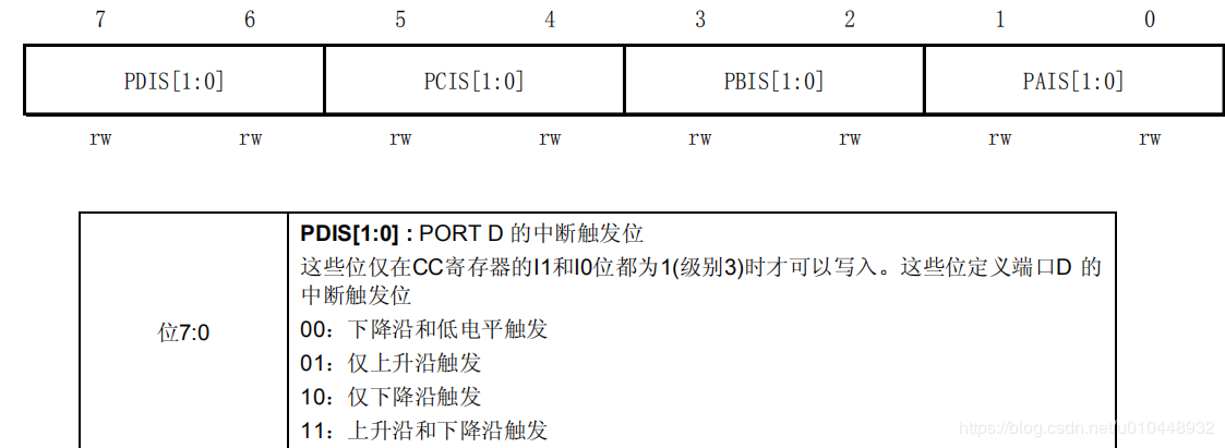

1、中断的使用   EXTI_SetExtIntSensitivity
外部中断控制寄存器 1 (EXTI_CR1)
void EXTI_SetExtIntSensitivity(EXTI_Port_TypeDef Port, EXTI_Sensitivity_TypeDef SensitivityValue)
    /* Check function parameters */
    assert_param(IS_EXTI_PORT_OK(Port));
    assert_param(IS_EXTI_SENSITIVITY_OK(SensitivityValue));
    /* Set external interrupt sensitivity */
    switch (Port)
    case EXTI_PORT_GPIOA:
        EXTI->CR1 &= (uint8_t)(~EXTI_CR1_PAIS);
        EXTI->CR1 |= (uint8_t)(SensitivityValue);
        break;
    case EXTI_PORT_GPIOB:
        EXTI->CR1 &= (uint8_t)(~EXTI_CR1_PBIS);
        EXTI->CR1 |= (uint8_t)((uint8_t)(SensitivityValue) << 2);
        break;
    case EXTI_PORT_GPIOC:
        EXTI->CR1 &= (uint8_t)(~EXTI_CR1_PCIS); //0x30
        EXTI->CR1 |= (uint8_t)((uint8_t)(SensitivityValue) << 4);
        break;
    case EXTI_PORT_GPIOD:
        EXTI->CR1 &= (uint8_t)(~EXTI_CR1_PDIS);
        EXTI->CR1 |= (uint8_t)((uint8_t)(SensitivityValue) << 6);
        break;
    case EXTI_PORT_GPIOE:
        EXTI->CR2 &= (uint8_t)(~EXTI_CR2_PEIS);
        EXTI->CR2 |= (uint8_t)(SensitivityValue);
        break;
    default:
        break;
#define IS_EXTI_SENSITIVITY_OK(SensitivityValue)
  (((SensitivityValue) == EXTI_SENSITIVITY_FALL_LOW) ||
   ((SensitivityValue) == EXTI_SENSITIVITY_RISE_ONLY) ||
   ((SensitivityValue) == EXTI_SENSITIVITY_FALL_ONLY) ||
   ((SensitivityValue) == EXTI_SENSITIVITY_RISE_FALL))
使用举例:
利用外部中断做按键检测
key 初始化
void Buttom_Init(void)
    GPIO_Init(GPIOB,Buttom2|Buttom1,GPIO_MODE_IN_PU_IT);
    EXTI_SetExtIntSensitivity(EXTI_PORT_GPIOB, EXTI_SENSITIVITY_FALL_ONLY);
中断向量指定的是Port_D  (注意每个port只有一个中断相应,触发后会跳入同一个中断函数)
中断响应 (stm8s_interruput.c)
__interrupt void EXTI_PORTB_IRQHandler(void)
  if((PB_IDR & 0x08)==0)  //PB4 FAIL
    delay_ms(10);
      UART1_SendString("PB4_Downn",
                              sizeof("PB4_Downn"));
      //**需要中断处理的函数放这**//

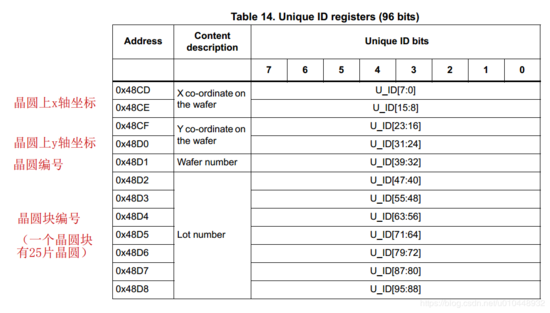

读取Unique ID
1.读出ID号
 #define     ID_BaseAddress         (0x48CD)     //stm8s105  具体的看芯片手册
void GetUniqueID(unsigned char *p)
     unsigned char i;
     unsigned char *pIDStart=(unsigned char *)(ID_BaseAddress);
     for(i=0;i!=12;i++){*p++=*pIDStart++;}
或者
u8 STM8S_ID[12];
void Get_STM8S_UniqueID(void)//Get STM8S Unique ID
    u8 i=0;
    for(i=0; i<12; i++)
        STM8S_ID[i] = *(u8*)(0x48CD+i);
