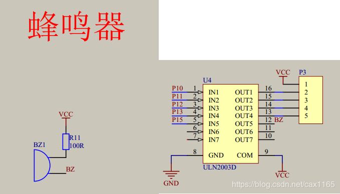

开发板蜂鸣器模块原理图如下:
#include
#define uc unsigned char
sbit beep=P1^5;
void delay(uc x)
uc i,j;
for(i=1;i<=x;i++)
for(j=1;j<=110;j++);
void main()
while(1)
beep=~beep;
        delay(5);//调节音调
