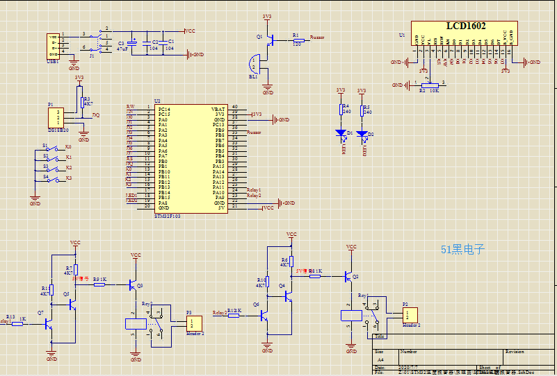

2020年08月07日 | 基于STM32的温度采集报警系统
2020-08-07 来源:51hei
单片机源程序如下:
#include "stm32f10x.h"
#include "delay.h"
#include "usart.h"
#include "LCD1602.h"
#include "led.h"
#include "ds18b20.h"
//Buzzer--------------->PB8
//LED1----------------->PB15
//LED2----------------->PA8
//Relay2--------------->PA9
//Relay1--------------->PA10
float Set_H = 35.0;  //高温报警温度
float Set_L = 10.0;  //低温报警温度
float Temp=0;        //实时温度
unsigned char SetFlag = 0;
//初始化按键 LED 继电器 蜂鸣器端口
void PortInit(void)
  GPIO_InitTypeDef GPIO_InitStructure;
        RCC_APB2PeriphClockCmd(RCC_APB2Periph_GPIOA, ENABLE);
  GPIO_InitStructure.GPIO_Pin = GPIO_Pin_8 | GPIO_Pin_9 | GPIO_Pin_10;
  GPIO_InitStructure.GPIO_Speed = GPIO_Speed_50MHz;
  GPIO_InitStructure.GPIO_Mode = GPIO_Mode_Out_PP;
  GPIO_Init(GPIOA, &GPIO_InitStructure);
        GPIO_SetBits(GPIOA,GPIO_Pin_8 | GPIO_Pin_9 | GPIO_Pin_10);
        RCC_APB2PeriphClockCmd(RCC_APB2Periph_GPIOB,ENABLE);
  GPIO_InitStructure.GPIO_Pin = GPIO_Pin_8 | GPIO_Pin_15;
  GPIO_Init(GPIOB, &GPIO_InitStructure);
        GPIO_SetBits(GPIOB,GPIO_Pin_8 | GPIO_Pin_15);
/*-------------------按键初始化-------------------------*/
        GPIO_InitStructure.GPIO_Pin = GPIO_Pin_10 | GPIO_Pin_11 | GPIO_Pin_12 | GPIO_Pin_13;
  GPIO_InitStructure.GPIO_Mode = GPIO_Mode_IPU;    //设置成输入模式
        GPIO_SetBits(GPIOB,GPIO_Pin_10 | GPIO_Pin_11 | GPIO_Pin_12 | GPIO_Pin_13);
void CoolingStart(void)
        GPIO_ResetBits(GPIOB,GPIO_Pin_8);
        GPIO_ResetBits(GPIOA,GPIO_Pin_9 | GPIO_Pin_8);
void CoolingStop(void)
        GPIO_SetBits(GPIOB,GPIO_Pin_8);
        GPIO_SetBits(GPIOA,GPIO_Pin_9 | GPIO_Pin_8);
void HeatStart(void)
  GPIO_ResetBits(GPIOA,GPIO_Pin_10);
  GPIO_ResetBits(GPIOB,GPIO_Pin_15);
void HeatStop(void)
  GPIO_SetBits(GPIOA,GPIO_Pin_10);
  GPIO_SetBits(GPIOB,GPIO_Pin_15);
unsigned char KeyVal(void)
  unsigned char key='0';  //无效返回255
        uint16_t Read;
        Read=GPIO_ReadInputData(GPIOB);  //读取GPIOB的数值
        Read >>= 10;
        Read &= 0x000F;
  if(0x0F!=Read)
          delay_ms(10);
          Read >>= 10;
          Read &= 0x000F;
                if(0x0F!=Read)
                  switch(Read)
                          case 0x0E:
                                { key = 'A'; }break;   //确认按键
                    case 0x0D:
        { key = '-'; }break;   //减
        case 0x0B:
        { key = '+'; }break;   //加
        case 0x07:
        { key = 'S'; }break;   //设置
        default: break;
        return key;
/*-----------------------位选函数---------------------------*/
void BitSelect(void)
  if('S'==KeyVal())
          while('S'==KeyVal());
          SetFlag++;
                if(SetFlag>5)
                        SetFlag=0;
void SetDisplay(void)
  if('+'==KeyVal() || '-'==KeyVal())  //如果有按键按下
        else
          switch(SetFlag)
                  case 0:
                        {  LCD_DisChar(1,3,' ');  }break;
                        case 1:
                        {  LCD_DisChar(1,4,' ');  }break;
                        case 2:
                        {  LCD_DisChar(1,6,' ');  }break;
                        case 3:
                        {  LCD_DisChar(1,11,' '); }break;
                        case 4:
                        {  LCD_DisChar(1,12,' '); }break;
                        case 5:
                        {  LCD_DisChar(1,14,' ');  }break;
                        default:break;
        delay_ms(120);
        LCD_DisFloat(1,2,Set_H,5,1);
        LCD_DisFloat(1,10,Set_L,5,1);
  delay_ms(120);
void SetVal(void)     //数值设置函数
  if('+'==KeyVal())
          switch(SetFlag)
                        case 0:
                          if(Set_H<90)
                                        Set_H+=10;
                                else
                                        Set_H = 100;
                        }break;
                        case 1:
                          if(Set_H<99)
                                  Set_H+=1;
                                else
                                        Set_H = 100;
                        }break;
                        case 2:
                          if(Set_H<99.8)
                                  Set_H+=0.1;
                                else
                                        Set_H = 100;
                        }break;
                        case 3:                   //低温限度不能高于高温限度-1
                          if(Set_L                Set_L+=10;
