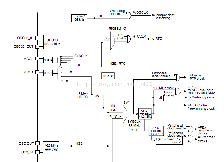

综上,可以得出默认配置中:
锁相环压腔振荡器时钟PLL_VCO = 25 / 25 * 336 = 336MHz
系统时钟SYSCLK = 336 / 2 = 168MHz
USB,SD卡时钟 = 336 / 7 = 48MHz
时钟图:

默认配置:
HCLK = SYSCLK / 1 = 168MHz
PCLK2 = HCLK / 2 = 84MHz
PCLK1 = HCLK / 4 = 42MHz
