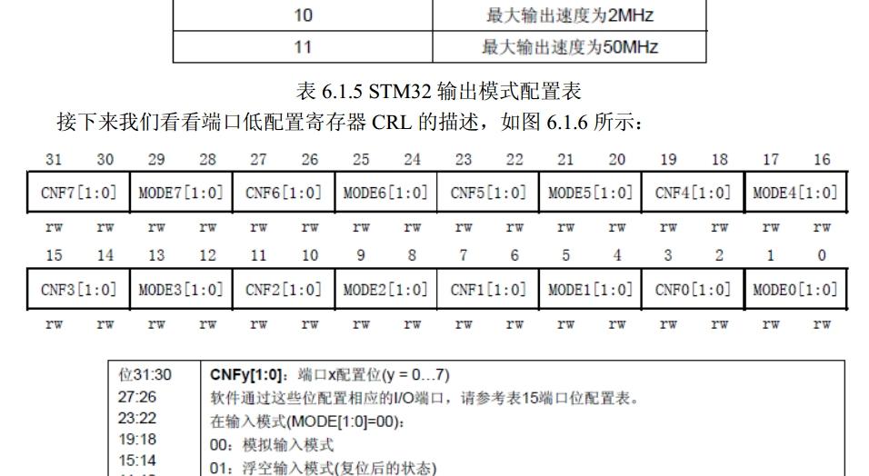

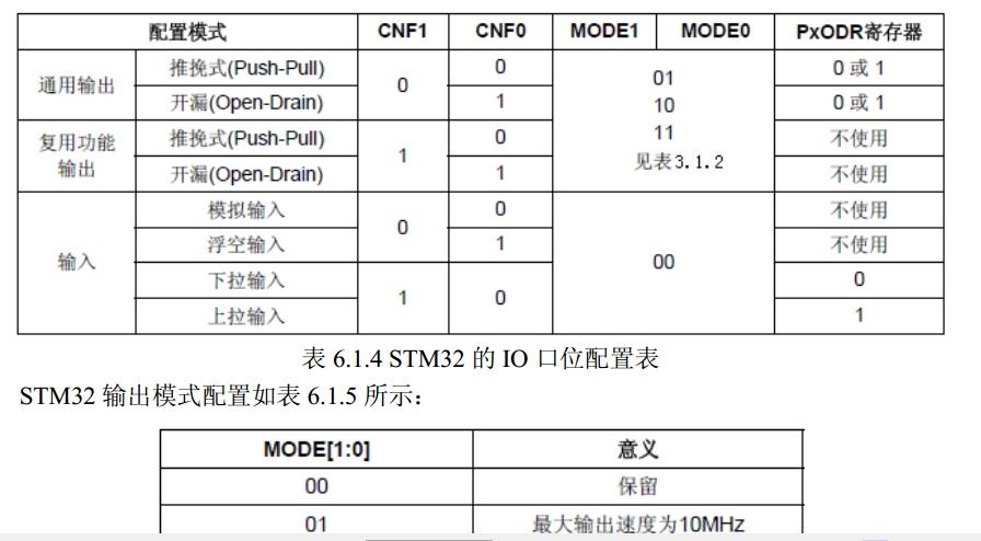

原理图:
程序:
#include "stm32f10x.h"
GPIO_InitTypeDef GPIO_InitStructure;
#define LED1_ON GPIO_SetBits(GPIOB, GPIO_Pin_5);
//#define LED1_ON GPIO_WriteBit(GPIOB, GPIO_Pin_5, Bit_SET);
#define LED1_OFF GPIO_ResetBits(GPIOB, GPIO_Pin_5);
//#define LED1_OFF GPIO_WriteBit(GPIOB, GPIO_Pin_5, Bit_RESET) ;
#define LED2_ON GPIO_SetBits(GPIOD, GPIO_Pin_6);
#define LED2_OFF GPIO_ResetBits(GPIOD, GPIO_Pin_6);
#define LED3_ON GPIO_SetBits(GPIOD, GPIO_Pin_3);
#define LED3_OFF GPIO_ResetBits(GPIOD, GPIO_Pin_3);
void RCC_Configuration(void);
void LED_Config(void);
void Delay(__IO uint32_t nCount);
* 名 称:void LED_Config(void)
* 功 能:LED 控制初始化函数
输入
void LED_Config(void){
RCC_APB2PeriphClockCmd(RCC_APB2Periph_GPIOB | RCC_APB2Periph_GPIOD , ENABLE);
GPIO_InitStructure.GPIO_Pin = GPIO_Pin_5; //LED1 V6 //将V6,V7,V8 配置为通用推挽输出
GPIO_InitStructure.GPIO_Mode = GPIO_Mode_Out_PP;
GPIO_InitStructure.GPIO_Speed = GPIO_Speed_50MHz; //口线翻转速度为50MHz
GPIO_Init(GPIOB, &GPIO_InitStructure);
GPIO_InitStructure.GPIO_Pin = GPIO_Pin_6|GPIO_Pin_3; //LED2, LED3 V7 V8
GPIO_Init(GPIOD, &GPIO_InitStructure);
// GPIO_Init(GPIOD, &GPIO_InitStructure);
GPIO_InitStructure.GPIO_Pin = GPIO_Pin_13; //LCD背光控制
GPIO_ResetBits(GPIOD, GPIO_Pin_13); //LCD背光关闭
* 名 称:int main(void)
* 功 能:主函数
int main(void)
RCC_Configuration(); //系统时钟配置
LED_Config();//LED控制配置
while (1)
LED1_ON; LED2_OFF; LED3_OFF;//LED1亮 LED2,LED3灭(LED2,LED3 仅V5 V3,V2,V2.1板有)
Delay(0xAFFFF);
LED1_OFF; LED2_ON; LED3_OFF;//LED2亮 LED1,LED3灭(LED2,LED3 仅V5 V3,V2,V2.1板有)
Delay(0xAFFFF);
LED1_OFF; LED2_OFF; LED3_ON;//LED3亮 LED1,LED2灭(LED2,LED3 仅V5 V3,V2,V2.1板有)
Delay(0xAFFFF);
* 名 称:void RCC_Configuration(void)
* 功 能:系统时钟配置为72MHZ
* 入口参数:无
* 出口参数:无
* 说 明:
* 调用方法:无
SystemInit();
* 名 称:void Delay(__IO uint32_t nCount)
* 功 能:延时函数
* 入口参数:无
* 出口参数:无
* 说 明:
* 调用方法:无
for(; nCount != 0; nCount--);
