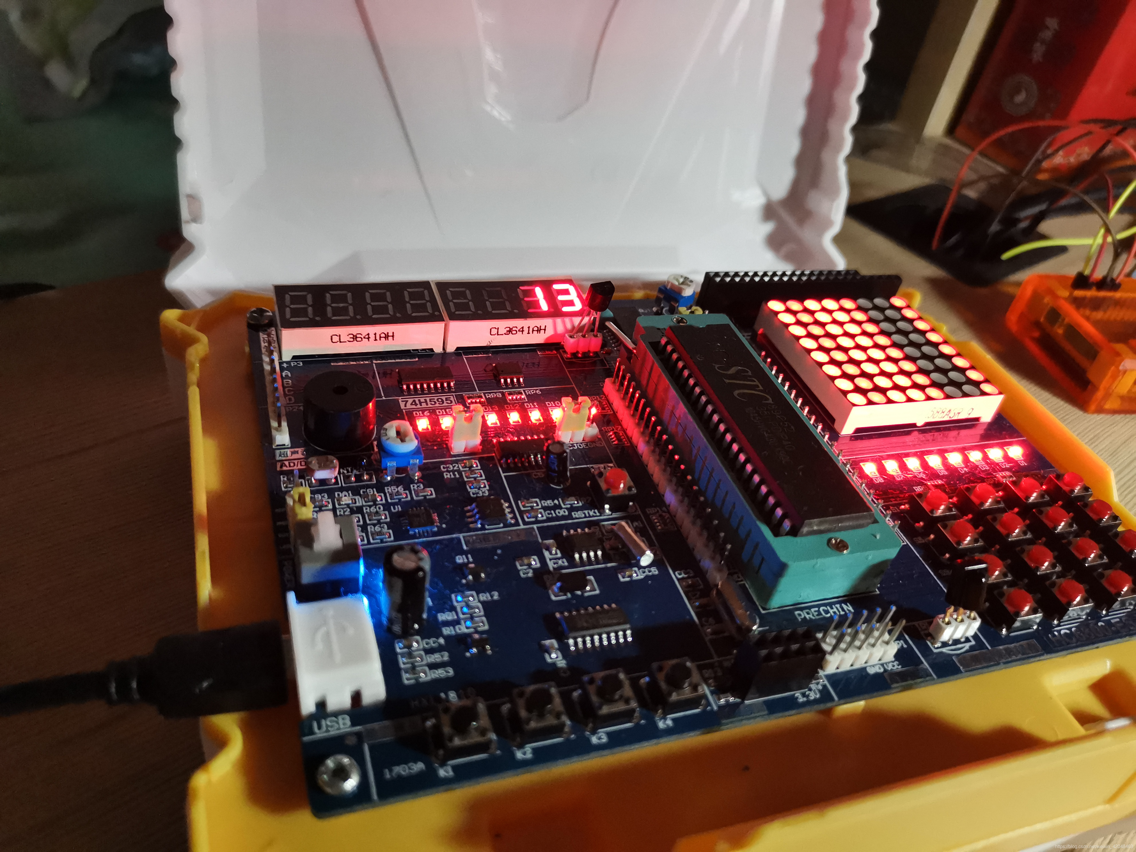

之前用轮询方式实现了定时器精准定时, 这里用前后台系统架构实现倒计时器.
每10ms都会触发一次中断处理程序T0_INT(), 根据tcount的值, 决定显示个位数字还是十位数字: 当tcount = 100时, 将tcount置回初始值0, 并将sec的值减1. 当sec的值减到-1时, 将sec重新置回15.
#include
unsigned char code DIG_CODE[10] = {0x3f, 0x06, 0x5b, 0x4f, 0x66, 0x6d, 0x7d, 0x07, 0x7f, 0x6f};//对应数码管显示0~9
int tcount = 0;//记录经过的10ms区间段个数
int sec = 15;//倒计时初始值
void T0_INT() interrupt 1 //timer0中断, 每10ms触发一次
TR0 = 0;//关闭timer0
TH0 = 0xD8;
TL0 = 0xF0;//65536 - 10000 = 55536
if(tcount % 2 == 0)
//显示个位数
P2 = 0;// P2 = 0 -> (P24, P23, P22) = (0, 0, 0) -> 右数第一个数字点亮
P0 = DIG_CODE[sec % 10];
tcount ++;
else if(tcount % 2 == 1)
//显示十位数
P2 = 1 << 2;//P2 = 0000 0100 -> (P24, P23, P22) = (0, 0, 1) -> 右数第二个数字点亮
P0 = DIG_CODE[sec / 10];
tcount ++;
if(tcount == 100) //10ms * 100 = 1000ms = 1s -> 1s时间到
tcount = 0;
sec --;
if(sec == -1)
sec = 15;
TR0 = 1;//重新开启timer0
int main()
TMOD = 0x01;
TH0 = 0xD8;
IE = 0x82;//EA + ET0 -> 1000 0010
TR0 = 1;//开启timer0
while(1)
return 0;
