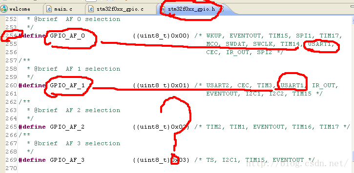

#include "stm32f0xx.h"
#include "stm32_lib/inc/stm32f0xx_rcc.h"
#include "stm32_lib/inc/stm32f0xx_gpio.h"
#include "stm32_lib/inc/stm32f0xx_usart.h"
int main(void)
//1、使能时钟
RCC_APB2PeriphClockCmd(RCC_APB2Periph_USART1,ENABLE);
//特别注意:因为串口有使用GPIO,所以对应GPIO的时钟也要使能
RCC_AHBPeriphClockCmd(RCC_AHBPeriph_GPIOA, ENABLE);

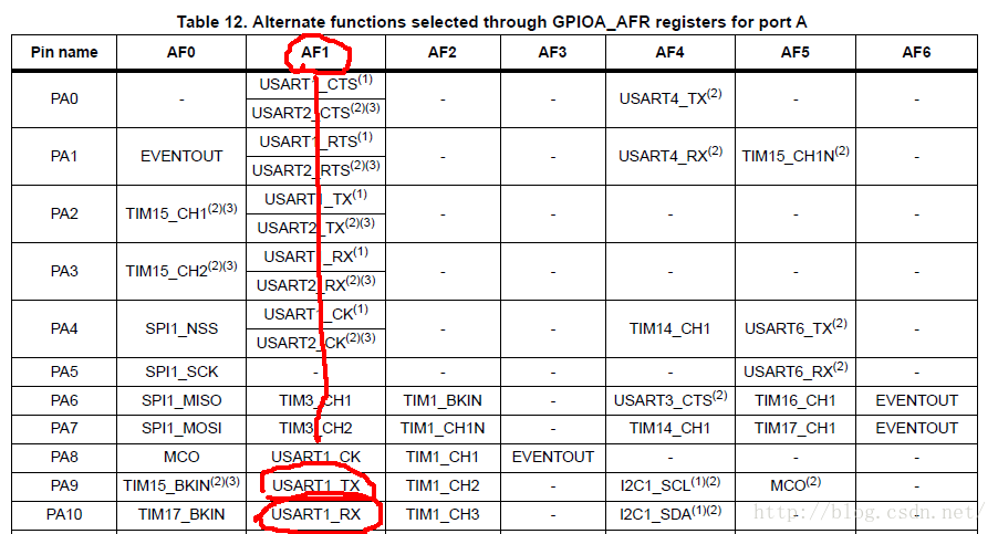

//2、选择引脚
//TX有PA2和PA9可选,RX有PA3和PA10可选
//GPIO_PinAFConfig(GPIOA,GPIO_PinSource2,GPIO_AF_1);
//GPIO_PinAFConfig(GPIOA,GPIO_PinSource3,GPIO_AF_1);
GPIO_PinAFConfig(GPIOA,GPIO_PinSource9,GPIO_AF_1);//为什么是AF1,而不是AF0呢?见下图,数据手册才是准确的
GPIO_PinAFConfig(GPIOA,GPIO_PinSource10,GPIO_AF_1);
