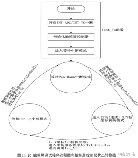

1.整体流程图
上图中的AdcTsIntHandle是总的中断,里面会进行判断,如果是ADC中断,则调用ADC中断函数,如果是触摸屏中断,那么就调用触摸屏中断函数。
2.touchscreen.c

void enter_wait_pen_down_mode(void)
ADCTSC = WAIT_PEN_DOWN | PULLUP_ENABLE | YM_ENABLE | YP_DISABLE | XP_DISABLE | XM_DISABLE | WAIT_INT_MODE;
void enter_wait_pen_up_mode(void)
ADCTSC = WAIT_PEN_UP | PULLUP_ENABLE | YM_ENABLE | YP_DISABLE | XP_DISABLE | XM_DISABLE | WAIT_INT_MODE;
void Isr_Tc(void)
printf("ADCUPDN = 0x%x, ADCDAT0 = 0x%x, ADCDAT1 = 0x%x, ADCTSC = 0x%xnr", ADCUPDN, ADCDAT0, ADCDAT1, ADCTSC);
if (ADCDAT0 & (1<<15))
printf("pen upnr");
enter_wait_pen_down_mode();
else
printf("pen downnr");
/* 进入"等待触摸笔松开的模式" */
enter_wait_pen_up_mode();
void AdcTsIntHandle(int irq)
if (SUBSRCPND & (1< Isr_Tc();
// if (SUBSRCPND & (1<// Isr_Adc();
SUBSRCPND = (1<}
void adc_ts_int_init(void)
SUBSRCPND = (1<
/* 注册中断处理函数 */
register_irq(31, AdcTsIntHandle);
/* 使能中断 */
INTSUBMSK &= ~((1< //INTMSK    &= ~(1<}
void adc_ts_reg_init(void)
/* [15] : ECFLG,  1 = End of A/D conversion
* [14] : PRSCEN, 1 = A/D converter prescaler enable
* [13:6]: PRSCVL, adc clk = PCLK / (PRSCVL + 1)
* [5:3] : SEL_MUX, 000 = AIN 0
* [2]   : STDBM
* [0]   : 1 = A/D conversion starts and this bit is cleared after the startup.
ADCCON = (1<<14) | (49<<6) | (0<<3);
ADCDLY = 0xff;
void touchscreen_init(void)
/* 设置触摸屏接口:寄存器 */
adc_ts_reg_init();
printf("ADCUPDN = 0x%x, SUBSRCPND = 0x%x, SRCPND = 0x%xnr", ADCUPDN, SUBSRCPND, SRCPND);
/* 设置中断 */
adc_ts_int_init();
/* 让触摸屏控制器进入"等待中断模式" */
