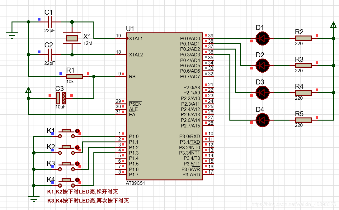

按键状态led显示
#include
#define uchar unsigned char
#define uint unsigned int
sbit LED1 = P0^0;
sbit LED2 = P0^1;
sbit LED3 = P0^2;
sbit LED4 = P0^3;
sbit K1 = P1^0;
sbit K2 = P1^1;
sbit K3 = P1^2;
sbit K4 = P1^3;
void DelayMS(uint x)
  uchar t;
while(x--)
for(t=120;t>0;t--);
void main()
  P0=0xff;
P1=0xff;
while(1)
LED1 = K1;
LED2 = K2;
if(K3==0)
while(K3==0)
LED3=~LED3;
if(K4==0)
while(K4==0)
LED4=~LED4;
DelayMS(10);
硬件连接:
在这里插入图片描述
