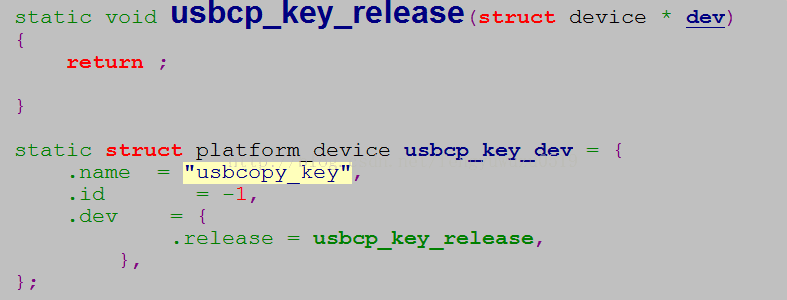

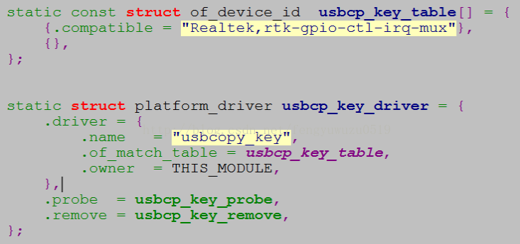

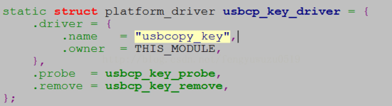

platform之前:
现在:

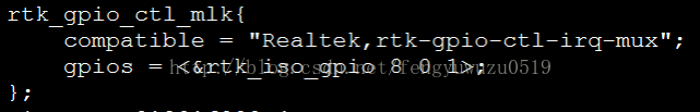

1、修改设备树文件支持GPIO按键中断
(/work/linux-4.4.0/linux-4.4/arch/arm/boot/dts/exynos4412-tiny4412.dts)
  1. interrupt_demo: interrupt_demo {
  2.         compatible         = "tiny4412,interrupt_demo";
  3.         tiny4412,int_gpio1 = <&gpx3 2 GPIO_ACTIVE_HIGH>;
  4.         tiny4412,int_gpio2 = <&gpx3 3 GPIO_ACTIVE_HIGH>;
  5.         tiny4412,int_gpio3 = <&gpx3 4 GPIO_ACTIVE_HIGH>;
  6.         tiny4412,int_gpio4 = <&gpx3 5 GPIO_ACTIVE_HIGH>;
  7. };
