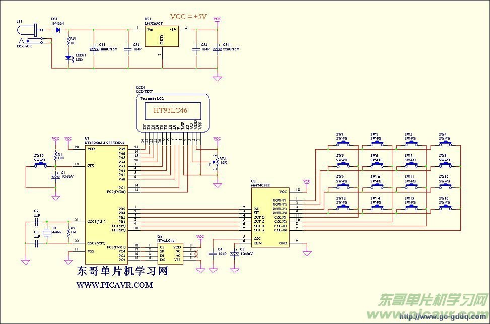

; Function :   基于HT48R50A的 93C46示例程序  *
; MICroProcessor : HT48R50A-1/28SKDIP-A      *
; Author:         www.picavr.com              *
; Crystal :       4MHz                       *
#INCLUDE                HT48R50A-1.INC
LCD_DATA                EQU     PA
LCD_DATA_CTRL           EQU     PAC
LCD_CTRL                EQU     PC
LCD_CTRL_CTRL           EQU     PCC
E                       EQU     1
RS                      EQU     0
KEYIN_ERROR             EQU     0AAH
EEPROM                  EQU     PC
CS                      EQU     5
SK                      EQU     4
DI                      EQU     3
DO                      EQU     2
