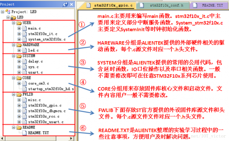

这里写图片描述
这里写图片描述

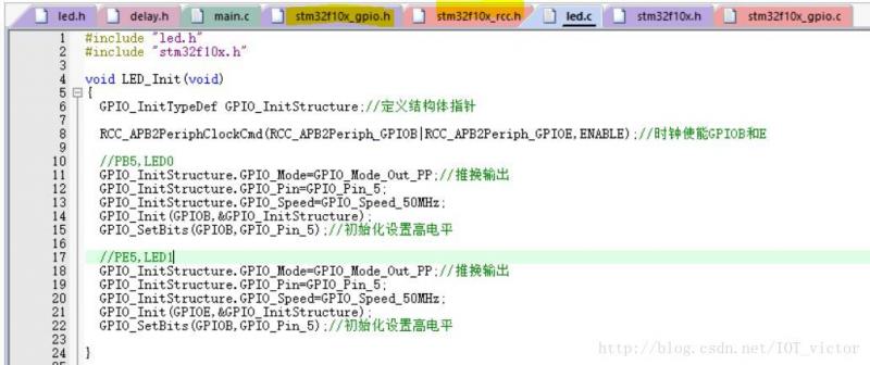

**led.c**
#include "led.h"
#include "stm32f10x.h"
void LED_Init(void)
    GPIO_InitTypeDef GPIO_InitStructure;//定义结构体指针
    RCC_APB2PeriphClockCmd(RCC_APB2Periph_GPIOB|RCC_APB2Periph_GPIOE,ENABLE);//时钟使能GPIOB和E

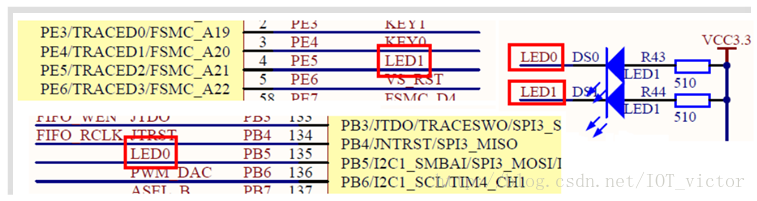

    //PB5,LED0
    GPIO_InitStructure.GPIO_Mode=GPIO_Mode_Out_PP;//推挽输出
    GPIO_InitStructure.GPIO_Pin=GPIO_Pin_5;
    GPIO_InitStructure.GPIO_Speed=GPIO_Speed_50MHz;
    GPIO_Init(GPIOB,&GPIO_InitStructure);
    GPIO_SetBits(GPIOB,GPIO_Pin_5);//初始化设置高电平
    //PE5,LED1
    GPIO_Init(GPIOE,&GPIO_InitStructure);
