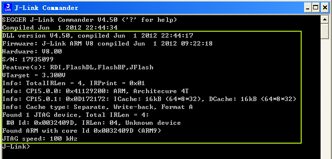

1.安装J-Link V8驱动,会默认安装J-Link Commander, J-Flash ARM, J-Mem,等。
2.J-Link仿真器和开发板mini2440相连接,执行J-Link Commander,出现如下信息,表明连接OK

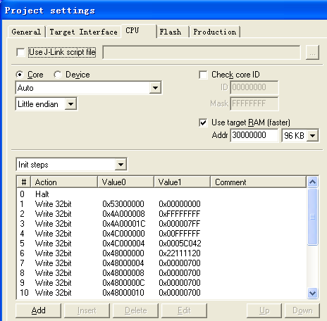

3.执行J-Flash ARM,按照如下进行配置
Ø  File==>New project
Ø  Options==>project settings
1) General : Connectioin to J-link --> USB : Device 0
2) Target Interface:设置JTAG,并且设置JTAG Speed 12000kHz(频率越高,下载速度越快)
3)CPU :  Core --> Auto, Little endian
Use target RAM(faster)-->Addr:30000000 96KB(主要是这个,不用的话就太慢了)
初始化序列(Init steps)按下面的填,从H-Jtag的script扒出来的
不懂得,请参考http://blog.csdn.net/wfq0624/article/details/7640392这篇博文
                   首先必须将默认的Inits steps中的第一步RESET action修改成Halt
Setmem+32-Bit+0x53000000+0x00000000
Setmem+32-Bit+0x4A000008+0xFFFFFFFF
Setmem+32-Bit+0x4A00001C+0x000007FF
Setmem+32-Bit+0x56000050+0x000055AA
Setmem+32-Bit+0x4C000014+0x00000007
Setmem+32-Bit+0x4C000000+0x00FFFFFF
Setmem+32-Bit+0x4C000004+0x00061012
Setmem+32-Bit+0x4C000008+0x00040042
Setmem+32-Bit+0x48000000+0x22111120
Setmem+32-Bit+0x48000004+0x00002F50
Setmem+32-Bit+0x48000008+0x00000700
Setmem+32-Bit+0x4800000C+0x00000700
Setmem+32-Bit+0x48000010+0x00000700
Setmem+32-Bit+0x48000014+0x00000700
Setmem+32-Bit+0x48000018+0x0007FFFC
Setmem+32-Bit+0x4800001C+0x00018005
Setmem+32-Bit+0x48000020+0x00018005
Setmem+32-Bit+0x48000024+0x008E0459
Setmem+32-Bit+0x48000028+0x00000032
Setmem+32-Bit+0x4800002C+0x00000030
Setmem+32-Bit+0x48000030+0x00000030
4)Flash :取消"Automatically detect flash memory",然后"Select Flash Device"。
mini2440的Flash型号是:SST39VF1601,选中之后不要改写任何数值。
      5)Production:选中 Erase, Program and Verify enable.
以上操作可以直接导入s3c2440.jflash文件,File==》open project==》s3c2440.jflash
