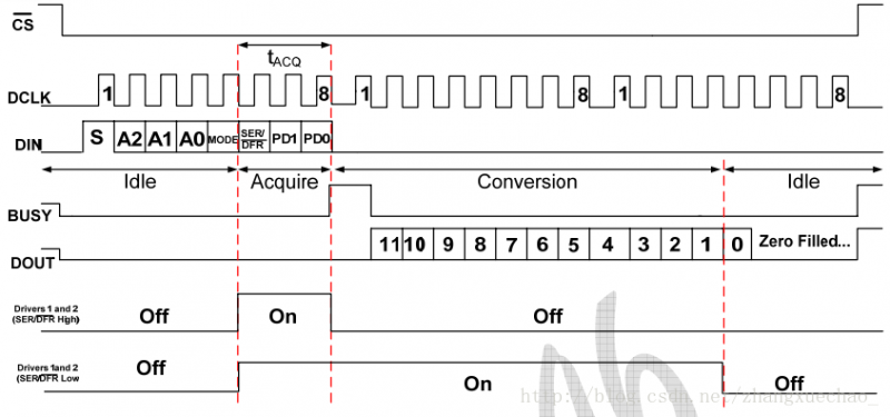

引脚功能描述

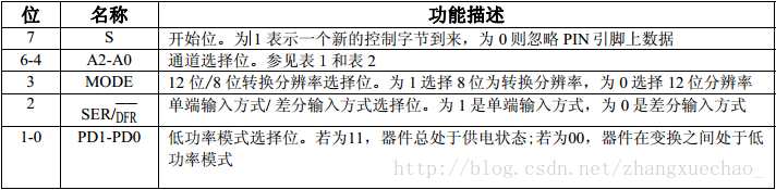

控制字的控制位命令
控制字节各位描述

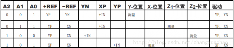

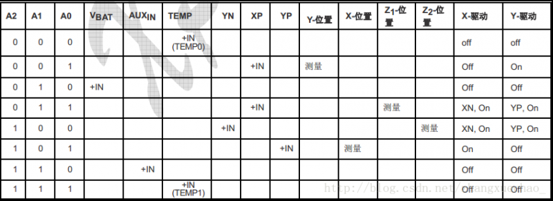

单端模式输入配置
差分模式输入配置
时序
前8个时钟用来通过DIN引脚输入控制字节,接着的12个时钟周期将完成真正的模数转换,剩下的3个多时钟周期将用来完成被转换器忽略的最后字节(DOUT置低)
举例

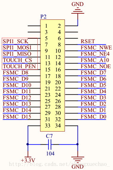

void TOUCH_init()
    GPIO_InitTypeDef gpioa =
        GPIO_Pin_5 | GPIO_Pin_6 | GPIO_Pin_7,
        GPIO_Speed_50MHz,
        GPIO_Mode_AF_PP
    GPIO_InitTypeDef gpiod6 =
        GPIO_Pin_6,
        GPIO_Speed_50MHz,
        GPIO_Mode_Out_PP
    GPIO_InitTypeDef gpiod7 =
        GPIO_Pin_7,
        GPIO_Speed_50MHz,
        GPIO_Mode_IPU
    SPI_InitTypeDef spi =
        SPI_Direction_2Lines_FullDuplex,
        SPI_Mode_Master, //0x0104
        SPI_DataSize_8b,
        SPI_CPOL_High,
        SPI_CPHA_2Edge,
        SPI_NSS_Soft,
        SPI_BaudRatePrescaler_256,
        SPI_FirstBit_MSB,
    RCC_APB2PeriphClockCmd(RCC_APB2Periph_SPI1 | RCC_APB2Periph_GPIOA | RCC_APB2Periph_GPIOD, ENABLE);
    GPIO_Init(GPIOA, &gpioa);
    GPIO_Init(GPIOD, &gpiod6);
    GPIO_Init(GPIOD, &gpiod7);
    SPI_Init(SPI1, &spi); //初始化SPI
    SPI_Cmd(SPI1, ENABLE); //使能SPI
