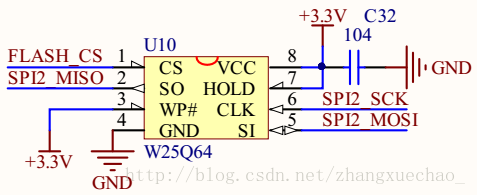

W25Q64
SPI配置步骤
1.使能SPI时钟
2.使能GPIO端口时钟
3.初始化GPIO,配置引脚模式
4.初始化SPI
5.使能SPI
6.SPI读写数据
7.查看SPI传输状态
举例

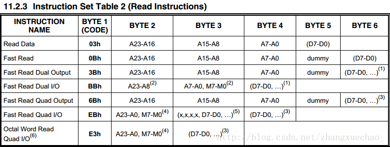

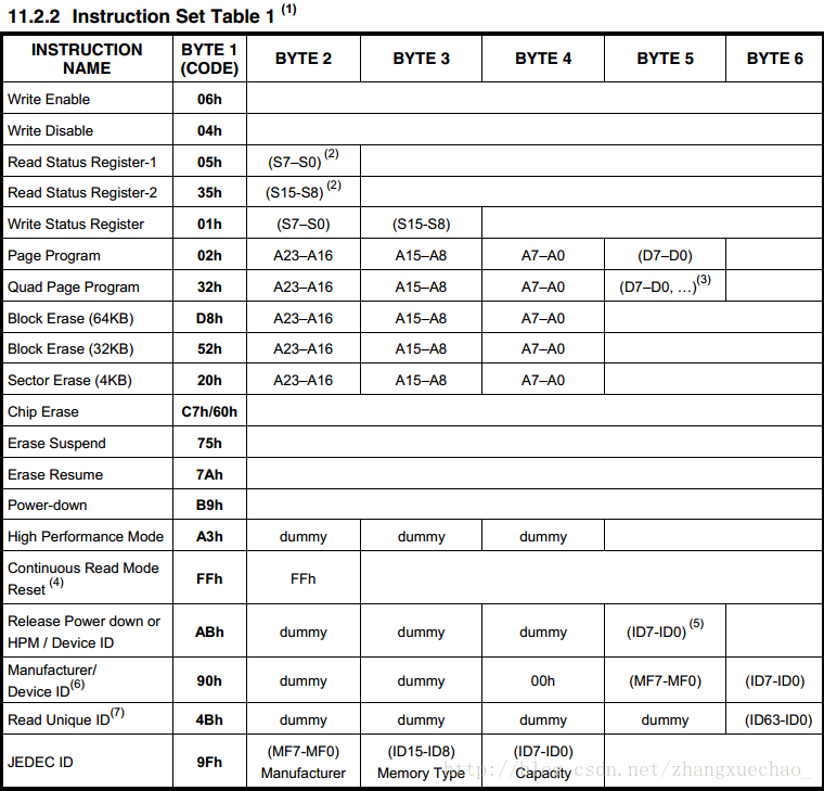

#define EN25X_WriteEnable 0x06
#define EN25X_WriteDisable 0x04
#define EN25X_ReadStatusReg 0x05
#define EN25X_WriteStatusReg 0x01
#define EN25X_ReadData 0x03
#define EN25X_FastReadData 0x0B
#define EN25X_FastReadDual 0x3B
#define EN25X_PageProgram 0x02
#define EN25X_BlockErase 0xD8
#define EN25X_SectorErase 0x20
#define EN25X_ChipErase 0xC7
#define EN25X_PowerDown 0xB9
#define EN25X_Continue_Read 0xFF
#define EN25X_ReleasePowerDown 0xAB
#define EN25X_DeviceID 0xAB
#define EN25X_ManufactDeviceID 0x90
#define EN25X_JedecDeviceID 0x9F

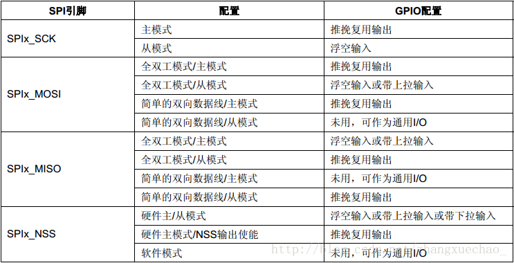

void SPI_init()
GPIO_InitTypeDef gpio =
GPIO_Pin_13 | GPIO_Pin_14 | GPIO_Pin_15,
GPIO_Speed_50MHz,
GPIO_Mode_AF_PP

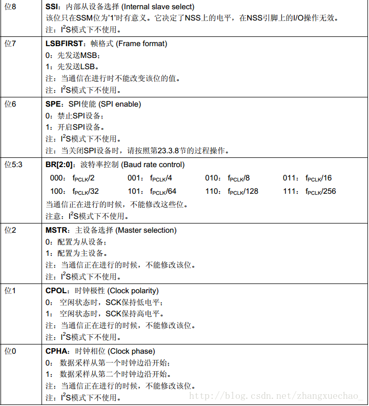

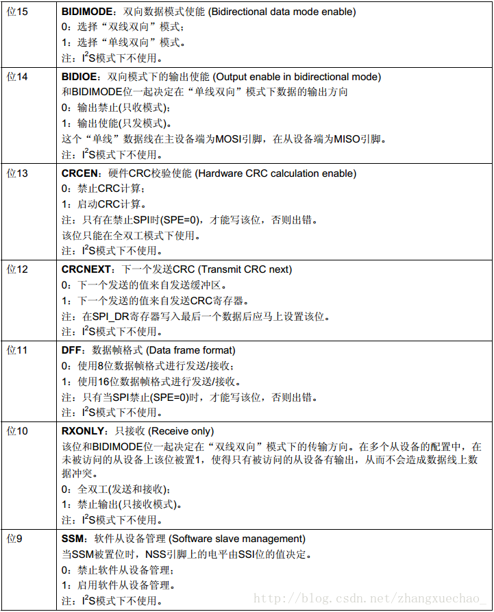

SPI_InitTypeDef spi =
SPI_Direction_2Lines_FullDuplex,
SPI_Mode_Master, //0x0104
SPI_DataSize_8b,
SPI_CPOL_High,
SPI_CPHA_2Edge,
SPI_NSS_Soft,
SPI_BaudRatePrescaler_256,
SPI_FirstBit_MSB,
RCC_APB1PeriphClockCmd(RCC_APB1Periph_SPI2, ENABLE); //使能SPI时钟
RCC_APB2PeriphClockCmd(RCC_APB2Periph_GPIOB, ENABLE); //使能GPIO端口时钟
GPIO_Init(GPIOB, &gpio); //初始化GPIO,配置引脚模式
SPI_Init(SPI2, &spi); //初始化SPI
SPI_Cmd(SPI2, ENABLE); //使能SPI
void SPI2_SetSpeed(u8 rate)
SPI2->CR1 &= 0xFFC7;
SPI2->CR1 |= rate;

u16 EN25Q64_read_id()
u16 r;
FLASH_CS = 0;
SPI_read_write(EN25X_ManufactDeviceID);
SPI_read_write(0); //dummy
SPI_read_write(0);
SPI_read_write(0);
r = SPI_read_write(EN25X_Continue_Read) << 8;
r = SPI_read_write(EN25X_Continue_Read);
FLASH_CS = 1;
return r;
void EN25Q64_read_unique_id(u8 *id)
int i = 0;
FLASH_CS = 0;
SPI_read_write(0x4B);
SPI_read_write(0);
SPI_read_write(0);
SPI_read_write(0);
for(i = 0; i < 8; i++)
id[i] = SPI_read_write(0xFF);
    FLASH_CS = 1;
u8 EN25Q64_read_status()
u8 r;
FLASH_CS = 0;
SPI_read_write(EN25X_ReadStatusReg);
FLASH_CS = 1;
return r;
void EN25Q64_read(u8 *buf, u32 addr, u16 num)
u16 i = 0;
FLASH_CS = 0;
SPI_read_write(EN25X_ReadData);
SPI_read_write((u8)(addr) >> 16); //24bit地址
SPI_read_write((u8)(addr) >> 8);
SPI_read_write((u8)addr);
for(i = 0; i < num; i++)
buf[i] = SPI_read_write(EN25X_Continue_Read);
FLASH_CS = 1;
