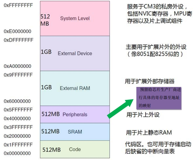

STM32的地址空间映射:

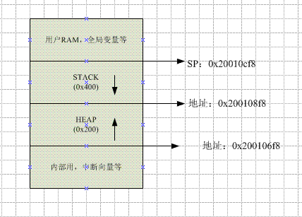

首先STM32的堆栈是存放在片上静态SRAM中的,地址分配可以见Keil的编译map文件:
HEAP  0x200106f8  Section  512  startup_stm32f2xx.o(HEAP)
STACK  0x200108f8  Section  1024  startup_stm32f2xx.o(STACK)
__heap_base  0x200106f8  Data  0  startup_stm32f2xx.o(HEAP)
__heap_limit  0x200108f8  Data  0  startup_stm32f2xx.o(HEAP)
__initial_sp  0x20010cf8  Data  0  startup_stm32f2xx.o(STACK)
上面节选中, __heap_base 是堆的基地址,__initial_sp  是栈指针 。示意图如下:
