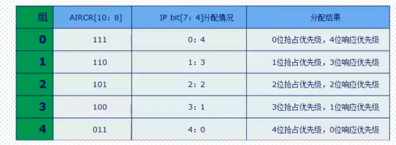

3.STM32的中断分组
1.通过配置SCB->AIRCR来处理
2.关于抢占优先级和响应优先级的介绍
1.对于抢占优先级和响应优先级,相对设置的数值越低,则相对更高
2.对于抢占优先级不同而言,优先级越高,可以在抢占优先级低的位置进行中断、
3.对于抢占优先级相同,但是响应优先级不同而言,响应优先级不能实现嵌套的中断,但是可以实现中断的先后顺序,在响应优先级高的位置则先进行中断
3.关于中断分组的库函数设置方法
void NVIC_PriorityGroupConfig(uint32_t NVIC_PriorityGroup)//ÖжÏÓÅÏȼ¶ÉèÖÃ
  /* Check the parameters */
  assert_param(IS_NVIC_PRIORITY_GROUP(NVIC_PriorityGroup));
  /* Set the PRIGROUP[10:8] bits according to NVIC_PriorityGroup value */
  SCB->AIRCR = AIRCR_VECTKEY_MASK | NVIC_PriorityGroup;
4.中断函数初始化的库函数设置
void NVIC_Init(NVIC_InitTypeDef* NVIC_InitStruct)
  uint32_t tmppriority = 0x00, tmppre = 0x00, tmpsub = 0x0F;
  assert_param(IS_FUNCTIONAL_STATE(NVIC_InitStruct->NVIC_IRQChannelCmd));
  assert_param(IS_NVIC_PREEMPTION_PRIORITY(NVIC_InitStruct->NVIC_IRQChannelPreemptionPriority));
  assert_param(IS_NVIC_SUB_PRIORITY(NVIC_InitStruct->NVIC_IRQChannelSubPriority));
  if (NVIC_InitStruct->NVIC_IRQChannelCmd != DISABLE)
    /* Compute the Corresponding IRQ Priority --------------------------------*/
    tmppriority = (0x700 - ((SCB->AIRCR) & (uint32_t)0x700))>> 0x08;
    tmppre = (0x4 - tmppriority);
    tmpsub = tmpsub >> tmppriority;
    tmppriority = (uint32_t)NVIC_InitStruct->NVIC_IRQChannelPreemptionPriority << tmppre;
    tmppriority |=  NVIC_InitStruct->NVIC_IRQChannelSubPriority & tmpsub;
    tmppriority = tmppriority << 0x04;
    NVIC->IP[NVIC_InitStruct->NVIC_IRQChannel] = tmppriority;
