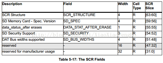

5)  SCR:In addition to the CSD register, there is another configurationregister named SD CARD Configuration Register (SCR). SCR provides informationon the SD Memory Card's special features that were configured into the givencard. The size of SCR register is 64 bits. This register shall be set in thefactory by the SD Memory Card manufacturer.
The following table describes the SCR register content.

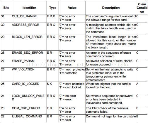

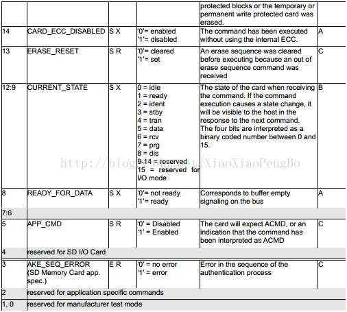

8)  CSR:The response format R1 contains a 32-bit field named cardstatus. This field is intended to transmit the card’s status information (whichmay be stored in a local status register) to the host. If not specifiedotherwise, the status entries are always related to the previous issuedcommand.

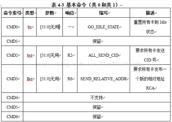

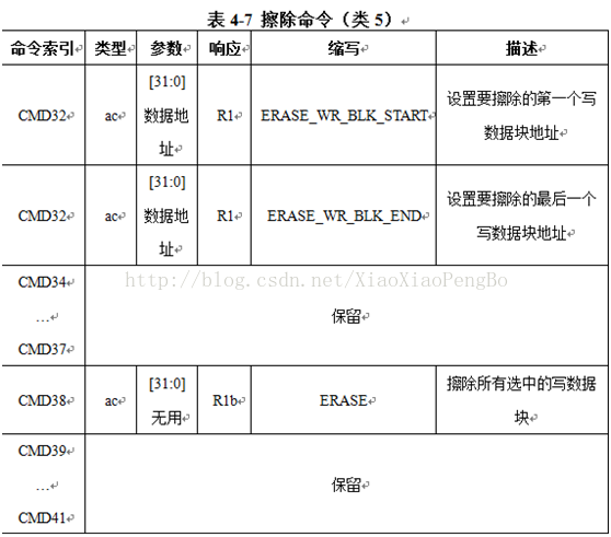

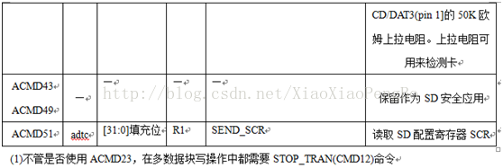

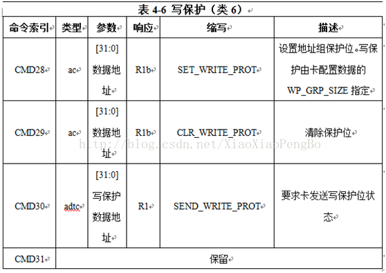

四.SD协议命令

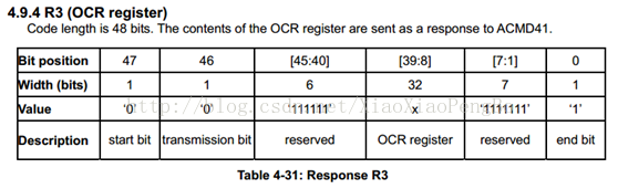

All responses are sent via the command line CMD. Theresponse transmission always starts with the left bit of the bit stringcorresponding to the response codeword. The code length depends on the responsetype.
A response always starts with a start bit (always 0),followed by the bit indicating the direction of transmission (card = 0). Avalue denoted by ‘x’ in the tables below indicates a variable entry. Allresponses except for the type R3 (see below) are protected by a CRC (seeChapter 4.5 for the definition of CRC7). Every command codeword is terminatedby the end bit (always 1). There are five types of responses for the SD MemoryCard. The SDIO Card supports additional response types named R4 and R5. Referto SDIO Card Spec for detailed information on the SDIO commands and responses.Their formats are defined as follows:

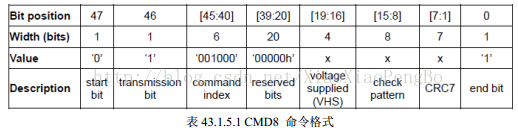

从图中,我们看到,不管什么卡(这里我们将卡分为4类:SD2.0高容量卡(SDHC,最大32G),SD2.0标准容量卡(SDSC,最大2G),SD1.x卡和MMC卡),首先我们要执行的是卡上电(需要设置SDIO_POWER[1:0]=11),上电后发送CMD0,对卡进行软复位,之后发送CMD8命令,用于区分SD卡2.0,只有2.0及以后的卡才支持CMD8命令,MMC卡和V1.x的卡,是不支持该命令的。CMD8的格式如表所示:

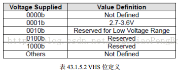

这里,我们需要在发送CMD8的时候,通过其带的参数我们可以设置VHS位,以告诉SD卡,主机的供电情况,VHS位定义如表所示
这里我们使用参数0X1AA,即告诉SD卡,主机供电为2.7~3.6V之间,如果SD卡支持CMD8,且支持
该电压范围,则会通过CMD8的响应(R7)将参数部分原本返回给主机,如果不支持CMD8,或者不支持这个电压范围,则不响应。在发送CMD8后,发送ACMD41(注意发送ACMD41之前要先发送CMD55),来进一步确认卡的操作电压范围,并通过HCS位来告诉SD卡,主机是不是支持高容量卡(SDHC)。

ACMD41得到的响应(R3)包含SD卡OCR寄存器内容,OCR寄存器内容定义如表所示:
对于支持CMD8指令的卡,主机通过ACMD41的参数设置HCS位为1,来告诉SD卡主机支SDHC卡,如果设置为0,则表示主机不支持SDHC卡,SDHC卡如果接收到HCS为0,则永远不会反回卡就绪状态。对于不支持CMD8的卡,HCS位设置为0即可。
SD卡在接收到ACMD41后,返回OCR寄存器内容,如果是2.0的卡,主机可以通过判断OCR的CCS位来判断是SDHC还是SDSC;如果是1.x的卡,则忽略该位。OCR寄存器的最
后一个位用于告诉主机SD卡是否上电完成,如果上电完成,该位将会被置1。

至此,我们便实现了对SD卡的类型区分,图中,最后发送了CMD2和CMD3命令,用于获得卡CID寄存器数据和卡相对地址(RCA)。

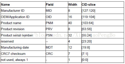

CMD2,用于获得CID寄存器的数据,CID寄存器数据各位定义如表所示:
SD卡在收到CMD2后,将返回R2长响应(136位),其中包含128位有效数据(CID寄
存器内容),存放在SDIO_RESP1~4等4个寄存器里面。通过读取这四个寄存器,就可以获得
SD卡的CID信息。
CMD3,用于设置卡相对地址(RCA,必须为非0),对于SD卡(非MMC卡),在收到
CMD3后,将返回一个新的RCA给主机,方便主机寻址。RCA的存在允许一个SDIO接口挂
多个SD卡,通过RCA来区分主机要操作的是哪个卡。而对于MMC卡,则不是由SD卡自动
返回RCA,而是主机主动设置MMC卡的RCA,即通过CMD3带参数(高16位用于RCA设
置),实现RCA设置。同样MMC卡也支持一个SDIO接口挂多个MMC卡,不同于SD卡的
是所有的RCA都是由主机主动设置的,而SD卡的RCA则是SD卡发给主机的。

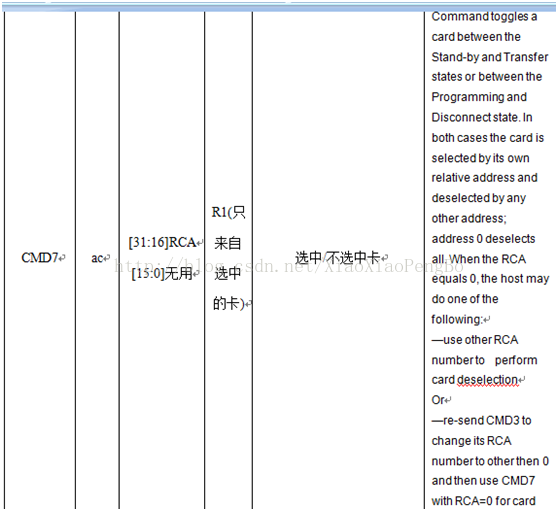

在获得卡RCA之后,我们便可以发送CMD9(带RCA参数),获得SD卡的CSD寄存器
内容,从CSD寄存器,我们可以得到SD卡的容量和扇区大小等十分重要的信息
