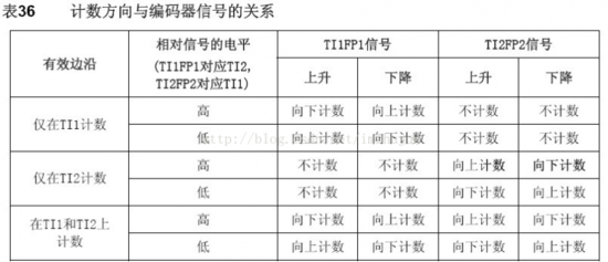

如图,STM32的每个TIMER都有正交编码器输入接口,TI1,TI2经过输入滤波,边沿检测产生TI1FP1,TI2FP2接到编码器模块,通过配置编码器的工作模式,即可以对编码器进行正向/反向计数。
如下图,编码器使用了A,B两相信号,但是我只需要对TI1信号进行计数(第一行),我也是刚发现了这个错误,原来对两个信号都计数,导致码盘转一周得到不止100个脉冲(100线的光电码盘)。通过STM32的编码器模块比较两想的电平信号就可以很容易地计算出编码器的运行情况了。
代码如下:
void Decoder_Configuration(void)
    GPIO_InitTypeDef GPIO_InitStructure;
    TIM_TimeBaseInitTypeDef TIM_TimeBaseStructure;
    TIM_ICInitTypeDef TIM_ICInitStructure;
    RCC_APB2PeriphClockCmd(RCC_APB2Periph_GPIOA, ENABLE);
    GPIO_StructInit(&GPIO_InitStructure);
    /* Configure PA.06,07 as encoder input */
    GPIO_InitStructure.GPIO_Pin = GPIO_Pin_6 | GPIO_Pin_7;
    GPIO_InitStructure.GPIO_Mode = GPIO_Mode_IN_FLOATING;
    GPIO_Init(GPIOA, &GPIO_InitStructure);
    RCC_APB1PeriphClockCmd(RCC_APB1Periph_TIM3, ENABLE);
    TIM_DeInit(TIM3);
    TIM_TimeBaseInit(TIM3, &TIM_TimeBaseStructure);
    TIM_TimeBaseStructure.TIM_Period = 2000;
    TIM_TimeBaseStructure.TIM_Prescaler = 0;
    TIM_TimeBaseStructure.TIM_ClockDivision = TIM_CKD_DIV1;
    TIM_TimeBaseStructure.TIM_CounterMode = TIM_CounterMode_Up;
    TIM_EncoderInterfaceConfig(TIM3, TIM_EncoderMode_TI12, TIM_ICPolarity_Rising,
            TIM_ICPolarity_Rising);
    TIM_ICStructInit(&TIM_ICInitStructure);
    TIM_ICInitStructure.TIM_ICFilter = 6;
    TIM_ICInit(TIM3, &TIM_ICInitStructure);
    TIM_ClearFlag(TIM3, TIM_FLAG_Update);
    TIM_ITConfig(TIM3, TIM_IT_Update, ENABLE);
    //Reset counter
    TIM3->CNT = 1000;
    TIM_Cmd(TIM3, ENABLE);
