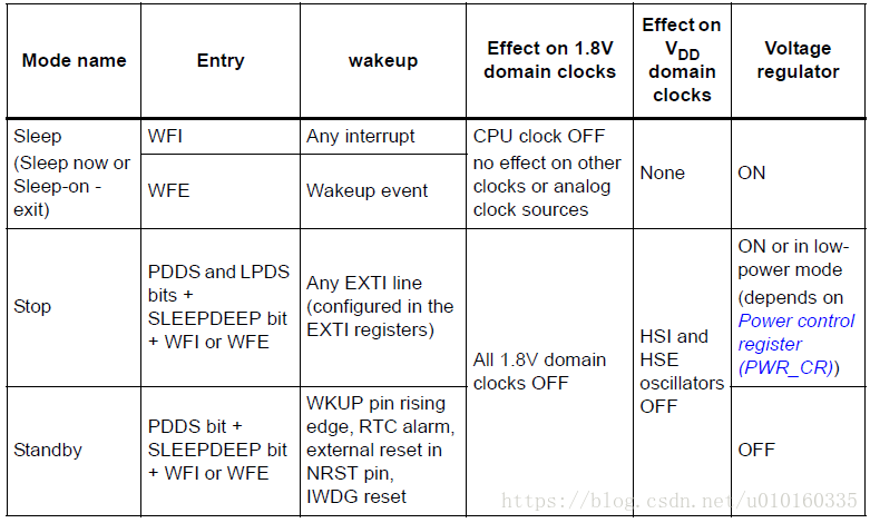

在STM32应用中,为了降低功耗共有以下三种工作模式:
Sleep mode
CPU clock off, all peripherals including ARM® Cortex®-M0 core peripherals like NVIC, SysTick, etc. are kept running..
In Sleep mode, only the CPU is stopped. All peripherals continue to operate and can wake up the CPU when an interrupt/event occurs.
Stop mode
all clocks are stopped
(Stop mode achieves very low power consumption while retaining the content of SRAM and registers. All clocks in the 1.8 V domain are stopped, the PLL, the HSI RC and the HSE crystal oscillators are disabled. The voltage regulator can also be put either in normal or in low power mode.
The device can be woken up from Stop mode by any of the EXTI lines. The EXTI line source can be one of the 16 external lines and RTC.)
Standby mode
1.8V domain powered-off
The Standby mode is used to achieve the lowest power consumption. The internal
voltage regulator is switched off so that the entire 1.8 V domain is powered off. The
PLL, the HSI RC and the HSE crystal oscillators are also switched off. After entering Standby mode, SRAM and register contents are lost except for registers in the RTC domain and Standby circuitry.
The device exits Standby mode when an external reset (NRST pin), an IWDG reset, a rising edge on the WKUP pins, or an RTC event occurs.
备注:
The RTC, the IWDG, and the corresponding clock sources are not stopped by entering Stop or Standby mode.

三种低功耗模式对比
Low-power mode summary

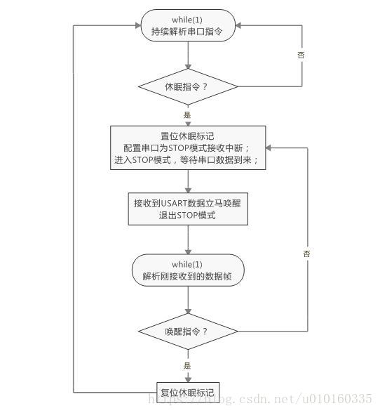

实际参考代码
然而,在STM32F030中不能配置为USART的start位唤醒。
#define USART_IT_WU ((uint32_t)0x00140316) /*!< Not available for STM32F030 devices */
解决办法,配置USART的接收非空中断:USART_IT_RXNE
