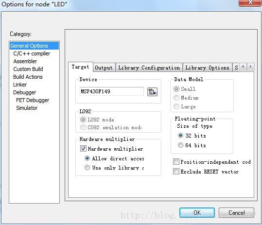

       General Options:Device MSP430F149.

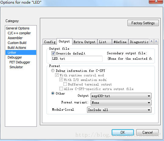

       Linker: Output--Override default
                     --board_test.txt
               Other --Output msp430-txt

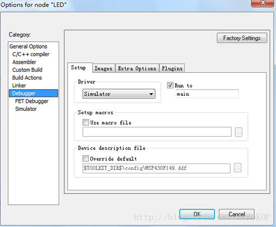

       Debugger:Driver Simulator

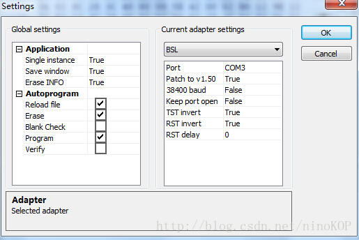

   BSL下载 MSPFET SETUP
       BSL:Port COM3
           Patch to v1.50 True
           38400 baud false
           keep port open false
           TST invert True
           RST invert True
       Auto
