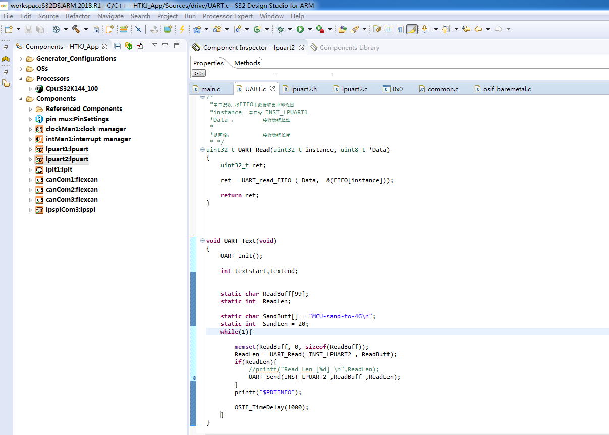

S32K144 自身NorFlash读写,在NXP官方编译器S32 Design Studio for ARM Version 2018.R1(需要打补丁跟新到 RTM2.0版SDK)直接编译。该串口代码与官方库不冲突,可继续使用官方提供的便利工具,IO和Uart模块的可视化配置,并且实现Uart方便的中断接受,不丢失。从FIFO中直接提取数据,改善官方SDK库效读取率低,操作不方便等问题。

**     Filename    : main.c
**     Processor   : S32K14x
**     Abstract    :
**         Main module.
**         This module contains user's application code.
**     Settings    :
**     Contents    :
**         No public methods
/* MODULE main */
/* Including necessary module. Cpu.h contains other modules needed for compiling.*/
#include "Cpu.h"
/* User includes (#include below this line is not maintained by Processor Expert) */
#include "common.h"
  brief The main function for the project.
  details The startup initialization sequence is the following:
int main(void)
  /* Write your local variable definition here */
  /*** Processor Expert internal initialization. DON'T REMOVE THIS CODE!!! ***/
  #ifdef PEX_RTOS_INIT
    PEX_RTOS_INIT();                   /* Initialization of the selected RTOS. Macro is defined by the RTOS component. */
  #endif
  /*** End of Processor Expert internal initialization.                    ***/
        BoardInit();
        UART_Text();
        while(1){
                OSIF_TimeDelay(1000);
        return 0;
/* END main */
