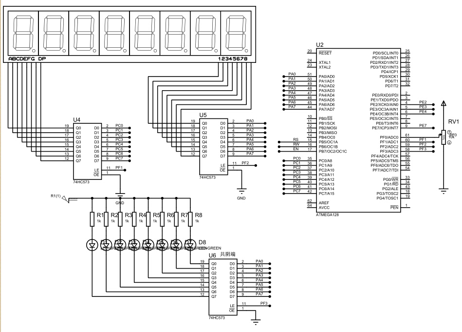

2019年10月18日 | 用带ADC的avr单片机做的一款电压检测表
2019-10-18 来源:eefocus
电压表效果
电路原理图如下:
单片机源码:
#include
#include
#define  uchar  unsigned char
#define  uint   unsigned int
void delayms(uint mS)        //微秒
        uint i,j;
        for( i=0;i                for(j=0;j<200;j++);
unsigned char disp[] = {0xC0,0xF9,0xA4,0xB0,0x99,0x92,0x82,0xF8,
                        0x80,0x90,0x88,0x83,0xC6,0xA1,0x86,0x8E};
uint ADC_Value;
void port_init(void)
   DDRD = 0xff;
   PORTD= 0x00;
   DDRE = 0xff;
   PORTE= 0x00;
   DDRF = 0x00;
   PORTF= 0x00;
void adc_init(void)
   ADMUX = 0x00;
   ADCSRA= 0x00;
   ACSR  =1<   ADMUX =(1<   ADCSRA=(1<
uint ADC_read(void)
   uint ADC_L,ADC_H,temp;
   ADCSRA |= (1<   ADC_L = ADCL;
   ADC_H = ADCH;
   temp  = (ADCH<<8)|ADC_L;
   return temp;
uint  convert(uint data)
   long temp1;
   uint temp2;
   temp1 = ((500 * (long)data)>>10);
   temp2 = (uint)temp1;
   return temp2;
void main(void)
     uint voltage;
     uchar n;
     port_init();
     adc_init();
         DDRA=0XFF;
         PORTA=0XFF;
         DDRC=0XFF;
         PORTC=0X00;
         DDRF|=0X0E;
         PORTF|=0X0E;
         PORTF&=0xF7;
         PORTA=0X00;
         DDRB |=0X10;
         PORTB|=0X10;
    while(1)
       ADC_Value = ADC_read();         //读取AD寄存器中的数值
       voltage   = convert(ADC_Value); //计算实际的输入电
       for(n=0;n<50;n++)
           display(voltage);               //显示
