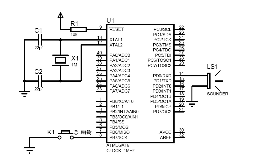

2019年10月23日 | AVR单片机定时器做的门铃程序+电路
2019-10-23 来源:51hei
#define F_CPU  1000000UL
#include
#include
#include
#define INT8U   unsigned char
#define INT16U  unsigned int
#define DoorBell() (PORTD ^= 0x01)          /
#define Key_DOWN() ((PINB & 0x80) == 0x00)
volatile INT16U soundDelay;                 //两个不同取值分别对应于"叮","咚"
int main()
        DDRB = 0;      PORTB = 0xff;
        DDRD = 0xff;
        TCCR1B = 0x01;
        TCNT1 = -700;
        sei();
        while(1)
                if( Key_DOWN() )
                        TIMSK = _BV(TOIE1);
                        soundDelay = -700;
                        _delay_ms(400);
                        soundDelay = -1000;
                        _delay_ms(600);
                        TIMSK = 0x00;
ISR ( TIMER1_OVF_vect )
        DoorBell();
                TCNT1 = soundDelay;
