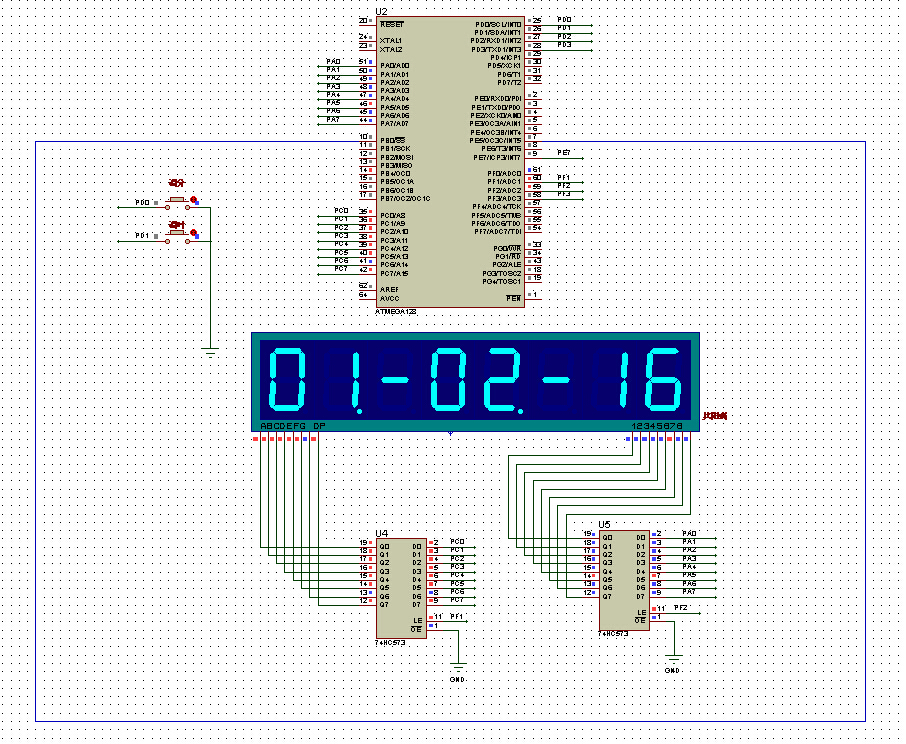

//------------2_8数码管键调时带小数点功能
#include
#define uchar unsigned char
#define uint  unsigned int
#define P0_1  PORTA |= (1<<0)
#define P0_0  PORTA &=~ (1<<0)
#define P1_1  PORTA |= (1<<1)
#define P1_0  PORTA &=~ (1<<1)
#define P2_1  PORTA |= (1<<2)
#define P2_0  PORTA &=~ (1<<2)
#define P3_1  PORTA |= (1<<3)
#define P3_0  PORTA &=~ (1<<3)
#define P4_1  PORTA |= (1<<4)
#define P4_0  PORTA &=~ (1<<4)
#define P5_1  PORTA |= (1<<5)
#define P5_0  PORTA &=~ (1<<5)
#define P6_1  PORTA |= (1<<6)
#define P6_0  PORTA &=~ (1<<6)
#define P7_1  PORTA |= (1<<7)
#define P7_0  PORTA &=~ (1<<7)
uchar i,m,h;
uint j;
uchar led_discode[]={0xc0,0xf9,0xa4,0xb0,0x99,
0x92,0x82,0xf8,0x80,0x90,0xbf,0xef,};     //共阳数码管数字码
void delay(uint mS)        //微秒
                uchar x,y;
                for(x=0;x                        for(y=0;y<10;y++);
void init(void)   //初始化PORUT口
        DDRA=0XFF;             //LED IO口设为输出
        PORTA=0X00;
        DDRB |=0X10;           //PB4设为输出
        PORTB|=0X10;           //关闭PB4外接的LED
        DDRC=0XFF;             //数码管段选设为输出
        PORTC=0X00;
        DDRF |=0X03;           //LED及数码管锁存IO口设为输出
        PORTF|=0X0E;
        PORTF&=0xF7;           //锁存数据关闭数码管
        DDRD=0;//全部设为输入
        PORTD=0xff;//全部上拉
        PIND=0xff;//设初始值
void playh(uchar h)
    PORTC = led_discode[h/10] ;
        P0_1;
        delay(1);
        P0_0;
        PORTC =tablee[h%10];
        P1_1;
        delay(1);
        P1_0;
    PORTC = led_discode[10] ;
        P2_1;
        delay(1);
        P2_0;
void key1(void)
        if(PIND == 0xfe)  //按键扫描函数----------加键
                delay(5);
                if(PIND == 0xfe)
                        while(PIND == 0xfe);
                m++;
        void key2(void)
        if(PIND == 0xfd)  //按键扫描函数----------减键
                delay(5);
                if(PIND == 0xfd)
                        while(PIND == 0xfd)        play(i);
        h++;
void main (viod)
        init() ;
        while(1)
                key1();
                key2();
                j=300;
                while(j--)
                        play(i); //显示函数
                i++;
                if(i==60)
                        i=0;    //如果秒计满60,将秒计数变量清0
                        m++;    //分钟计数变量加1
                if(m == 60)
                        m=0;    //如果分钟计满60,将分钟计数变量清0
                        h++;      //小时计数变量加1
                if(h == 24)
                        h=0;    //如果小时计满24,将小时计数变量清0
