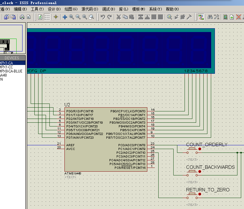

2019年10月24日 | ATMEGA48利用按键控制时钟proteus仿真
2019-10-24 来源:51hei
ATMEGA48时钟程序源码:
#include
//共阳数码管键码
const unsigned char disp_table_ca[]=
{  0xC0,0xF9,0xA4,0xB0,0x99,
    0x92,0x82,0xF8,0x80,0x90  };
char a_second=0;
char b_second=0;
int count=0,flag;
void delay(unsigned int x)
{ int i,j; for(i=0;i
void main()
{ DDRD=0xff;
  DDRB=0XFF;
  PORTC=0XFF;
  while(1)
           PORTB=0B00000001;
        PORTD=disp_table_ca[a_second];
        delay(1);
        PORTB=0B00000010;
        PORTD=disp_table_ca[b_second];
        delay(1);
        if((PINC&0B00000001)==0)
          delay(20);
          flag=1;
          while((PINC&0B00000001)==0);
        if((PINC&0B00000010)==0)
          delay(20);
          flag=2;
          while((PINC&0B00000010)==0);
        if((PINC&0B00000100)==0)
          delay(20);
          flag=3;
          while((PINC&0B00000100)==0);
        if(flag==1)
           count++;
           if(count%49==0)
           b_second++;
              if(b_second==10)
               b_second=0;
               a_second++;
                      if(a_second==6)
                      a_second=0;
        if(flag==2)
           count++;
           if(count%49==0)
           b_second--;
              if(b_second==-1)
               b_second=9;
               a_second--;
                      if(a_second==-1)
                      a_second=5;
        if(flag==3)
           a_second=0;
           b_second=0;
