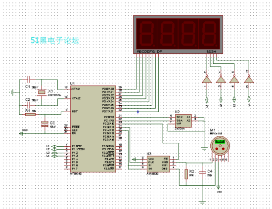

2019年10月29日 | 基于单片机的车辆超载监测系统
2019-10-29 来源:51hei
车辆超载检测仿真原理图如下
电子地秤单片机源程序如下:
//线性区间标度变换公式:    y=(115-15)/(243-13)*X+15kpa

//ADC0832的引脚
sbit ADCS =P2^2;  //ADC0832 chip seclect
sbit ADDI =P2^4;  //ADC0832 k in
sbit ADDO =P2^4;  //ADC0832 k out
sbit ADCLK =P2^3;  //ADC0832 clock signal
sbit SDA = P2 ^ 1;                                //数据线
sbit SCL = P2 ^ 0;                                //时钟线

读ADC0832函数
//采集并返回
unsigned int Adc0832(unsigned char channel)     //AD转换,返回结果
    unsigned char i=0;
    unsigned char j;
    unsigned int dat=0;
    unsigned char ndat=0;
    if(channel==0)channel=2;
    if(channel==1)channel=3;
