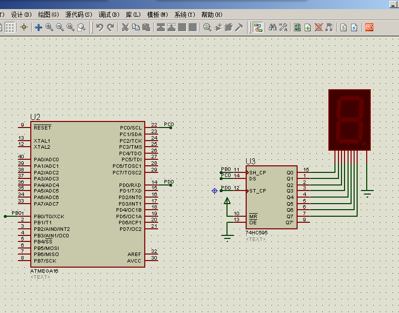

2019年10月30日 | AVR单片机通过74HC595驱动数码管显示
2019-10-30 来源:51hei
一个很简单的avr单片机的仿真,用74hc595芯片来驱动单个数码管显示数字,下面是仿真原理图
源程序:
#include
#include
void delay(int k){
         int i=0,j=0;
         for(i=0;i             for(j=0;j<6;j++){
void InputData(unsigned char data){
         unsigned char i;
         unsigned char k;
         for(i=0;i<8;i++){
            PORTB=~BIT(0);
                delay(20);
                PORTC=(data>>i)&0x01;
                delay(20);
                PORTB=BIT(0);
                delay(20);
void OutData(void){
         PORTD=~BIT(0);
         delay(40);
         PORTD=BIT(0);                          //上升沿送到锁存器
         delay(40);
         PORTD=~BIT(0);            //锁存显示
void main(){
         unsigned char i,j;
         unsigned char temp=0x0f;
         unsigned char str[8]={0xfc/*0*/,0x60/*1*/,0xda,/*2*/0xf2/*3*/,0x66/*4*/,0xb6/*5*/,0xbe/*6*/,0xe0/*7*/};
         DDRB=0XFF;
         DDRC =0XFF;
         DDRD=0XFF;
         while(1){
                 for(i=0;i<8;i++){
                    InputData(str[i]);
                        OutData();
                        delay(9000);
                        delay(9000);
                        delay(9000);
                        delay(9000);
                        delay(9000);
                        delay(9000);
                        delay(9000);
                        delay(9000);
                        delay(9000);
                        delay(9000);
                        delay(9000);
                        delay(9000);
                        delay(9000);
                        delay(9000);
                        delay(9000);
                        delay(9000);
                        delay(9000);
                        delay(9000);
