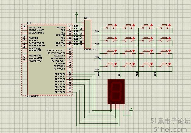

关于矩阵键盘的识别方法在51矩阵键盘识别中已经说过,现在要说的是PIC单片机与51单片机的区别,主要是PIC单片机的口子的输入输出需要TRISn寄存器设置,具体如下:
扫描法:
#include
#define uchar unsigned char
#define uint unsigned int
uchar num;
const ucharSSEG[]={0x3f,0x06,0x5b,0x4f,0x66,0x6d,0x7d,0x07,0x7f,0x6f,0x77,0x7c,0x39,0x5e,0x79,0x71};
void delay1ms(uint z)
uint x;
uchar y;
for(x=z;x>0;x--)
  for(y=110;y>0;y--);
void keyscan()
uchar temp;
TRISB=0x0f;
PORTB=0x7f;
temp=PORTB&0x0f;
if(temp!=0x0f)
  delay1ms(10);
  temp=PORTB&0x0f;
  if(temp!=0x0f)
   num=temp|0x70;
  temp=PORTB&0x0f;
  while(temp!=0x0f)
   temp=PORTB&0x0f;
  switch(num)
   case 0x7e:num =12;break;
    case0x7d: num =13;break;
   case 0x7b:num =14;break;
   case 0x77:num =15;break;
PORTB=0xbf;
temp=PORTB&0x0f;
if(temp!=0x0f)
  delay1ms(10);
  temp=PORTB&0x0f;
  if(temp!=0x0f)
   num=temp|0xb0;
  temp=PORTB&0x0f;
  while(temp!=0x0f)
   temp=PORTB&0x0f;
  switch(num)
   case 0xbe:num =8;break;
    case0xbd: num =9;break;
   case 0xbb:num =10;break;
   case 0xb7:num =11;break;
PORTB=0xdf;
temp=PORTB&0x0f;
if(temp!=0x0f)
  delay1ms(10);
  temp=PORTB&0x0f;
  if(temp!=0x0f)
   num=temp|0xd0;
  temp=PORTB&0x0f;
  while(temp!=0x0f)
   temp=PORTB&0x0f;
  switch(num)
   case 0xde:num =4;break;
    case0xdd: num =5;break;
   case 0xdb:num =6;break;
   case 0xd7:num =7;break;
PORTB=0xef;
temp=PORTB&0x0f;
if(temp!=0x0f)
  delay1ms(10);
  temp=PORTB&0x0f;
  if(temp!=0x0f)
   num=temp|0xe0;
  temp=PORTB&0x0f;
  while(temp!=0x0f)
   temp=PORTB&0x0f;
  switch(num)
   case 0xee:num =0;break;
    case0xed: num =1;break;
   case 0xeb:num =2;break;
   case 0xe7:num =3;break;
void main()
num=0xff;
TRISD=0;
PORTD=0;
while(1)
  keyscan();
  PORTD=~SSEG[num];
线反转法:
#include
uchar num;
uint x;
uchar y;
for(x=z;x>0;x--)
  for(y=110;y>0;y--);
void keyscan()
uchar temp,z,x;
TRISB=0x0f;
PORTB=0x0f;
x=PORTB&0x0f;
if(x!=0x0f)
  delay1ms(10);
  x=PORTB&0x0f;
  if(x!=0x0f)
   temp=PORTB&0x0f;
   TRISB=0xf0;
   PORTB=0xf0;
   z=temp|PORTB;
   x=PORTB&0xf0;
   while(x!=0xf0)//松手检测
    x=PORTB&0xf0;
   switch(z)
    case0xee: num =0; break;
         case 0xde: num =4; break;
         case 0xbe: num =8; break;
         case 0x7e: num =12; break;
         case 0xed: num =1; break;
         case 0xdd: num =5; break;
         case 0xbd: num =9; break;
         case 0x7d: num =13; break;
         case 0xeb: num =2; break;
         case 0xdb: num =6;break;
         case 0xbb: num =10;break;
         case 0x7b: num =14;break;
         case 0xe7: num =3;break;
         case 0xd7: num =7;break;
         case 0xb7: num =11;break;
         case 0x77: num =15;break;
void main()
num=0xff;
TRISD=0;
PORTD=0;
while(1)
  keyscan();
  PORTD=~SSEG[num];
