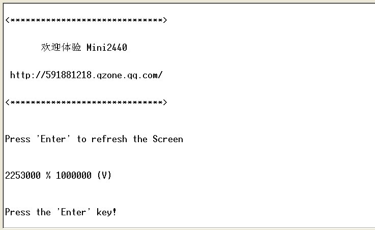

2019年11月18日 | Mini2440裸机程序之ADC
2019-11-18 来源:51hei
源代码及注释
#define GLOBAL_CLK  1
#include
#include
#include "def.h"
#include "option.h"
#include "2440addr.h"
#include "2440lib.h"
#include "2440slib.h"
#include "mmu.h"
#include "memtest.h"
#include "Mylib.h"
#define LED1 (1 << (5 * 2))
#define LED2 (1 << (6 * 2))
#define LED3 (1 << (7 * 2))
#define LED4 (1 << (8 * 2))
#define LEDS (LED1 | LED2 | LED3 | LED4)
#define LED1_ON   ~(1<<5)
#define LED2_ON   ~(1<<6)
#define LED3_ON   ~(1<<7)
#define LED4_ON   ~(1<<8)
#define LED1_OFF   (1<<5)
#define LED2_OFF   (1<<6)
#define LED3_OFF   (1<<7)
#define LED4_OFF   (1<<8)
void init()
    cal_cpu_bus_clk();//在MyLib.h中有定义
    Uart_Init(0,115200);//PCLK、波特率为115200
    Uart_Select(0);//选择串口0
    My_Logo();//在MyLib.h中有定义
int ADC_Test()
    int temp;
    rADCCON = (1<<14)|(0x31<<6)|(0<<3);//预分频器使能、预分频值为49、通道0
    rADCCON |=0x1;// A/D开始转换,开始之后,此位被清除
    while(rADCCON&0x1);//检测有没有开始
    while(!(rADCCON&0x8000));//检测转换是否结束
    temp = rADCDAT0&0x3ff;//返回转换值,正常A/D转换的数值只能通过ADCDAT0寄存器的[9:0]位读取
    return temp;
void Main(void)
    int temp,Value;
    U8 key;
    init();
    MMU_Init();//内存初始化
    rGPBCON = LEDS;   //初始化LED相应引脚为输出
    rGPBDAT = rGPBDAT|(LED1_OFF)|(LED2_OFF)|(LED3_OFF)|(LED4_OFF); // LED 灭
    rGPBDAT &= ~(0x1);
    Uart_Printf("nnnPress 'Enter' to refresh the Screenn");//终端提示
    while(1)
           temp = ADC_Test();//调用A/D转换函数
           Value = ((3300/1024)*temp)*1000;//转换成电压值,单位mV,Value值比实际值放大了1000倍
           key=Uart_Getch();//等待从键盘接收按键
           Beep(2000,100);//蜂鸣器发声函数
           // 刷新A/D转换,原因很简单,我们往往在等待按键时调整电位器
           temp = ADC_Test();
           rGPBCON = LEDS;   //还原GPB的配置,原因调用了蜂鸣器发声函数,改变了GPB原先的配置
          if(key==ENTER_KEY)//判断是否按了Enter键
               key=0;//按键清零
               rGPBDAT = (~temp)&(~0x1);//输出到LED显示,务必把GPB0清零,否则你将会有麻烦 ^|^
               Uart_Printf("nnn%d %% 1000000 %(V%)n",Value);//把电压值输出到终端显示
          else
               key=0;
               Uart_Printf("nnnPress the 'Enter' key!n");//按键非Enter键,提示按键
程序结果
