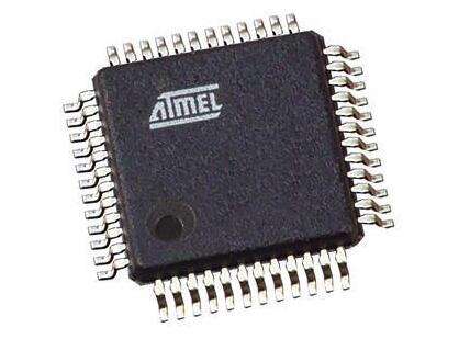

2019年12月23日 | AVR单片机的串口查询设计
2019-12-23 来源:elecfans
* Code adapted from Atmel AVR ApplICation Note AVR306
* PolLEDmode driver forUART, this is the similar to the
* library default putchar() and getchar() in ICCAVR
#include
AVR单片机的串口查询设计
#include
#include “uart.h”
/* iniTIalize UART */
void InitUART( unsigned char baudrate )
UBRR = baudrate; /* set the baud rate */
UCR = BIT(RXEN) | BIT(TXEN); /* enable UART receiver and transmitter */
/* Read and write funcTIons */
unsigned char ReceiveByte( void )
while ( !(USR & (1《; /* return the data */
return UDR;
void TransmitByte( unsigned char data )
while ( !(USR & (1《; /* wait for empty transmit buffer */
UDR = data; /* start transmitTIon */
#ifdef TEST
/* main - a simple test program*/
void main( void )
InitUART( 11 ); /* set the baudrate to 19,200 bps using a
3.6864MHzcrystal */
while ( 1 ) /* forever */
TransmitByte( ReceiveByte() ); /* echo the received character */
#endif
