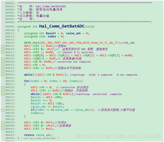

STM8L之ADC
*名    称: Hal_Comm_GetBatADC
*功    能: 获取电池电量信息
*入口参数: 无
*出口参数: 电量AD值
*说    明:
unsigned int Hal_Comm_GetBatADC(void)
unsigned int Result = 0, value_adc = 0;
unsigned char index = 0;
  GPIO_Init(VOL_ADC_PORT,VOL_ADC_PIN,GPIO_Mode_In_FL_No_IT);//VOL_ADC
  ADC1->CR1 |= 0x01;//使能AD
  ADC1->CR3 &= ~0x1F;//  选择采样时间 384 周期  通道清空
  ADC1->CR3 |= 0x00;  // channel 0 is selected
  ADC1->SQR[0] = ADC1->SQR[1] = ADC1->SQR[2] = ADC1->SQR[3] = 0x00;
  ADC1->SQR[3] = 0x01;// 选择通道0扫描
  ADC1->SR &= 0x00;// conversion not complete
  ADC1->SR = 0;    // conversion 标识清空
  ADC1->CR1 |= 0x03;//使能AD并开始转换
  while(!(ADC1->SR & 0x01)); //waitloop   bit0: 1 complete   0 not complete
  for(index = 0; index < 10; index++)
    ADC1->CR1 |= 0x03;//使能AD  开始转换
    while(!(ADC1->SR & 0x01));//waitloop  conversion  complete
    Result = ADC1->DRH;     //总共计算16bit的值,但ADC为12 bit 长度
    Result <<= 8;           //ADC1->DRH为高8位,
    Result += ADC1->DRL;    //ADC1->DRL为低8位
    value_adc += Result;
if(index != 0)value_adc = value_adc/2;  //获取多次数据,计算平均值
    index++;
  ADC1->CR1 &= 0xFE;//关闭AD
  ADC1->CR3 &= ~0x1F;//选择通道
  ADC1->CR3 |= 0x11;
return value_adc;
