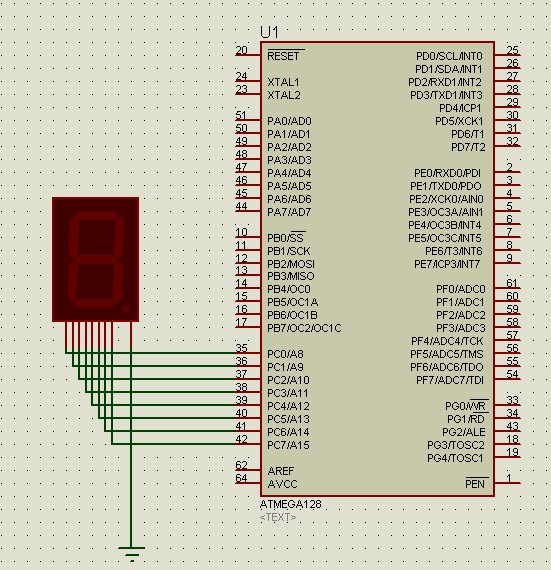

数码管选7SEG-MPX1-CC,共阴极数码管。也就是低电平选通(最右脚),数码管左边8只管脚,从左到右,由低到高,分别接PC0---PC7。
c程序如下:
#include
#include
#define int8u unsigned char
#define int16u unsigned int
const int8u seg_code[]={0x3f,0x06,0x5b,0x4f,0x66,0x6d,0x7d,0x07,0x7f,0x6f};
int main()
int8u i=0;
DDRC=0xff;
while(1)
PORTC=seg_code[i];
i=(i+1)%10; //i递增到10的时候,重新设为0
_delay_ms(200);
