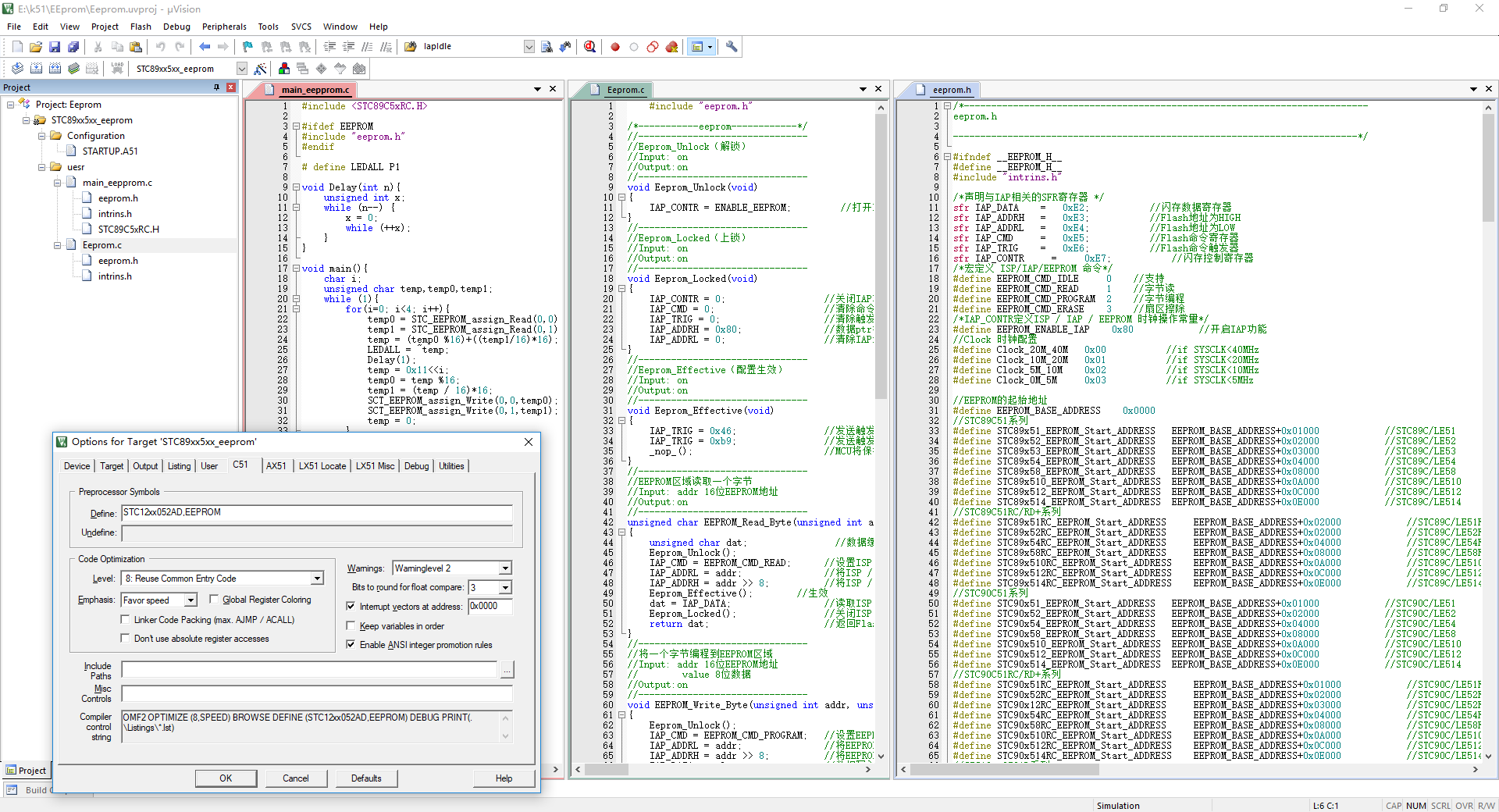

最近又看了一下关于stc单片机的知识,感觉在使用中EEPROM是个经常用到的东西,特地学习了一下,给大家分享一下心得,如有不足,多多包涵,废话不多说,一图解千言,先上图:
/*--------------------------------------------------------------分界线-----------------------------------------------------------------------------------*/
main_eepprom.c
 1 #include
 3 #ifdef EEPROM
 4 #include "eeprom.h"
 5 #endif
 7 # define LEDALL P1
 9 void Delay(int n){
10     unsigned int x;
11     while (n--) {
12         x = 0;
13         while (++x);
14     }
15 }
17 void main(){
18     char i;
19     unsigned char temp,temp0,temp1;
20     while (1){
21         for(i=0; i<4; i++){
22             temp0 = STC_EEPROM_assign_Read(0,0);
23             temp1 = STC_EEPROM_assign_Read(0,1);
24             temp = (temp0 %16)+((temp1/16)*16);
25             LEDALL = ~temp;
26             Delay(1);
27             temp = 0x11<28             temp0 = temp %16;
29             temp1 = (temp / 16)*16;
30             SCT_EEPROM_assign_Write(0,0,temp0);
31             SCT_EEPROM_assign_Write(0,1,temp1);
32             temp = 0;
33         }
34     }
35 }
Eeprom.h
  1 /*--------------------------------------------------------------------------
  2 eeprom.h
  4 --------------------------------------------------------------------------*/
  6 #ifndef __EEPROM_H__
  7 #define __EEPROM_H__
  8 #include "intrins.h"
 10 /*声明与IAP相关的SFR寄存器 */
 11 sfr IAP_DATA    =   0xE2;           //闪存数据寄存器
 12 sfr IAP_ADDRH   =   0xE3;           //Flash地址为HIGH
 13 sfr IAP_ADDRL   =   0xE4;           //Flash地址为LOW
 14 sfr IAP_CMD     =   0xE5;           //Flash命令寄存器
 15 sfr IAP_TRIG    =   0xE6;           //Flash命令触发器
 16 sfr IAP_CONTR     =     0xE7;           //闪存控制寄存器
 17 /*宏定义 ISP/IAP/EEPROM 命令*/
 18 #define EEPROM_CMD_IDLE        0    //支持
 19 #define EEPROM_CMD_READ        1    //字节读
 20 #define EEPROM_CMD_PROGRAM     2    //字节编程
 21 #define EEPROM_CMD_ERASE    3    //扇区擦除
 22 /*IAP_CONTR定义ISP / IAP / EEPROM 时钟操作常量*/
 23 #define EEPROM_ENABLE_IAP    0x80            //开启IAP功能
 24 //Clock 时钟配置
 25 #define Clock_20M_40M      0x00           //if SYSCLK<40MHz
 26 #define Clock_10M_20M      0x01           //if SYSCLK<20MHz
 27 #define Clock_5M_10M    0x02           //if SYSCLK<10MHz
 28 #define Clock_0M_5M     0x03           //if SYSCLK<5MHz
 29
 30 //EEPROM的起始地址
 31 #define EEPROM_BASE_ADDRESS    0x0000
 32 //STC89C51系列
 33 #define STC89x51_EEPROM_Start_ADDRESS   EEPROM_BASE_ADDRESS+0x01000            //STC89C/LE51
 34 #define STC89x52_EEPROM_Start_ADDRESS   EEPROM_BASE_ADDRESS+0x02000            //STC89C/LE52
 35 #define STC89x53_EEPROM_Start_ADDRESS   EEPROM_BASE_ADDRESS+0x03000            //STC89C/LE53
 36 #define STC89x54_EEPROM_Start_ADDRESS   EEPROM_BASE_ADDRESS+0x04000            //STC89C/LE54
 37 #define STC89x58_EEPROM_Start_ADDRESS   EEPROM_BASE_ADDRESS+0x08000            //STC89C/LE58
 38 #define STC89x510_EEPROM_Start_ADDRESS    EEPROM_BASE_ADDRESS+0x0A000            //STC89C/LE510
 39 #define STC89x512_EEPROM_Start_ADDRESS  EEPROM_BASE_ADDRESS+0x0C000            //STC89C/LE512
 40 #define STC89x514_EEPROM_Start_ADDRESS    EEPROM_BASE_ADDRESS+0x0E000            //STC89C/LE514
 41 //STC89C51RC/RD+系列
 42 #define STC89x51RC_EEPROM_Start_ADDRESS       EEPROM_BASE_ADDRESS+0x01000            //STC89C/LE51RC/RD+
 43 #define STC89x52RC_EEPROM_Start_ADDRESS       EEPROM_BASE_ADDRESS+0x02000            //STC89C/LE52RC/RD+
 44 #define STC89x54RC_EEPROM_Start_ADDRESS       EEPROM_BASE_ADDRESS+0x04000            //STC89C/LE54RC/RD+
 45 #define STC89x58RC_EEPROM_Start_ADDRESS       EEPROM_BASE_ADDRESS+0x08000            //STC89C/LE58RC/RD+
 46 #define STC89x510RC_EEPROM_Start_ADDRESS    EEPROM_BASE_ADDRESS+0x0A000            //STC89C/LE510RC/RD+
 47 #define STC89x512RC_EEPROM_Start_ADDRESS      EEPROM_BASE_ADDRESS+0x0C000            //STC89C/LE512RC/RD+
 48 #define STC89x514RC_EEPROM_Start_ADDRESS    EEPROM_BASE_ADDRESS+0x0E000            //STC89C/LE514RC/RD+
 49 //STC90C51系列
 50 #define STC90x51_EEPROM_Start_ADDRESS   EEPROM_BASE_ADDRESS+0x01000            //STC90C/LE51
 51 #define STC90x52_EEPROM_Start_ADDRESS   EEPROM_BASE_ADDRESS+0x02000            //STC90C/LE52
 52 #define STC90x54_EEPROM_Start_ADDRESS   EEPROM_BASE_ADDRESS+0x04000            //STC90C/LE54
 53 #define STC90x58_EEPROM_Start_ADDRESS   EEPROM_BASE_ADDRESS+0x08000            //STC90C/LE58
 54 #define STC90x510_EEPROM_Start_ADDRESS    EEPROM_BASE_ADDRESS+0x0A000            //STC90C/LE510
 55 #define STC90x512_EEPROM_Start_ADDRESS  EEPROM_BASE_ADDRESS+0x0C000            //STC90C/LE512
 56 #define STC90x514_EEPROM_Start_ADDRESS    EEPROM_BASE_ADDRESS+0x0E000            //STC90C/LE514
 57 //STC90C51RC/RD+系列
 58 #define STC90x51RC_EEPROM_Start_ADDRESS       EEPROM_BASE_ADDRESS+0x01000            //STC90C/LE51RC/RD+
 59 #define STC90x52RC_EEPROM_Start_ADDRESS       EEPROM_BASE_ADDRESS+0x02000            //STC90C/LE52RC/RD+
 60 #define STC90x12RC_EEPROM_Start_ADDRESS       EEPROM_BASE_ADDRESS+0x03000            //STC90C/LE52RC/RD+
 61 #define STC90x54RC_EEPROM_Start_ADDRESS       EEPROM_BASE_ADDRESS+0x04000            //STC90C/LE54RC/RD+
 62 #define STC90x58RC_EEPROM_Start_ADDRESS       EEPROM_BASE_ADDRESS+0x08000            //STC90C/LE58RC/RD+
 63 #define STC90x510RC_EEPROM_Start_ADDRESS    EEPROM_BASE_ADDRESS+0x0A000            //STC90C/LE510RC/RD+
 64 #define STC90x512RC_EEPROM_Start_ADDRESS      EEPROM_BASE_ADDRESS+0x0C000            //STC90C/LE512RC/RD+
 65 #define STC90x514RC_EEPROM_Start_ADDRESS    EEPROM_BASE_ADDRESS+0x0E000            //STC90C/LE514RC/RD+
 66 //STC12xx052AD系列
 67 #define STC12xx052AD_EEPROM_Start_ADDRESS       EEPROM_BASE_ADDRESS+0x00000        //STC12xx052AD
 68
 69
 70 //EEPROM SIZE
 71 #define Sector_size    0x0200
 72 //STC89C51系列
 73 #define STC89x51_EEPROM_Sector_Number     18
 74 #define STC89x52_EEPROM_Sector_Number    10
 75 #define STC89x53_EEPROM_Sector_Number    4
 76 #define STC89x54_EEPROM_Sector_Number    90
 77 #define STC89x58_EEPROM_Sector_Number      58
 78 #define STC89x510_EEPROM_Sector_Number    44
 79 #define STC89x512_EEPROM_Sector_Number    28
 80 #define STC89x514_EEPROM_Sector_Number    12
 81 //STC89C51RC/RD+系列
 82 #define STC89x51RC_EEPROM_Sector_Number     8
 83 #define STC89x52RC_EEPROM_Sector_Number        8
 84 #define STC89x54RC_EEPROM_Sector_Number        90
 85 #define STC89x58RC_EEPROM_Sector_Number      58
 86 #define STC89x510RC_EEPROM_Sector_Number    42
 87 #define STC89x512RC_EEPROM_Sector_Number    26
 88 #define STC89x514RC_EEPROM_Sector_Number    10
 89 //STC90C51系列
 90 #define STC90x51_EEPROM_Sector_Number     10
 91 #define STC90x52_EEPROM_Sector_Number    10
 92 #define STC90x54_EEPROM_Sector_Number    90
 93 #define STC90x58_EEPROM_Sector_Number      58
